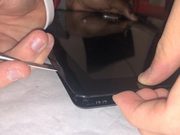

    • Insert the metal spudger into the side of the screen casing. Work the spudger around the perimeter of the casing in a rowing motion in order to release the plastic clips holding the casing together.
    • Place a finger in the space between the casing while undoing the clips to keep the casing from re-closing.

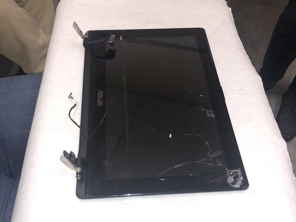

  12. Asus X200MA Screen Replacement: crwdns2935265:012crwdnd2935265:01crwdnd2935265:01crwdne2935265:0
    • Lift the half of the casing with the screen away from the other half of the casing and place the screen half on a work space by itself.
