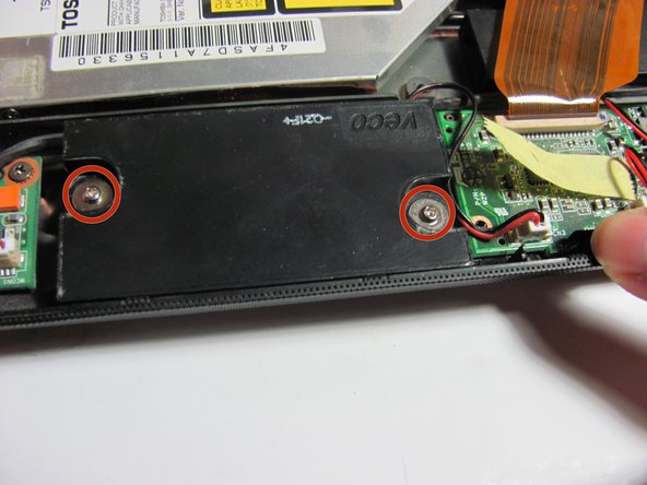

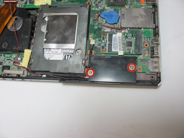

  13. Asus W2W-A1 Speaker Replacement, Speaker: crwdns2935265:013crwdnd2935265:01crwdnd2935265:03crwdne2935265:0 Asus W2W-A1 Speaker Replacement, Speaker: crwdns2935265:013crwdnd2935265:02crwdnd2935265:03crwdne2935265:0 Asus W2W-A1 Speaker Replacement, Speaker: crwdns2935265:013crwdnd2935265:03crwdnd2935265:03crwdne2935265:0
    • Remove the 2 4 mm, wide Phillips screws per speaker holding in the two speakers at the lower end of the device.

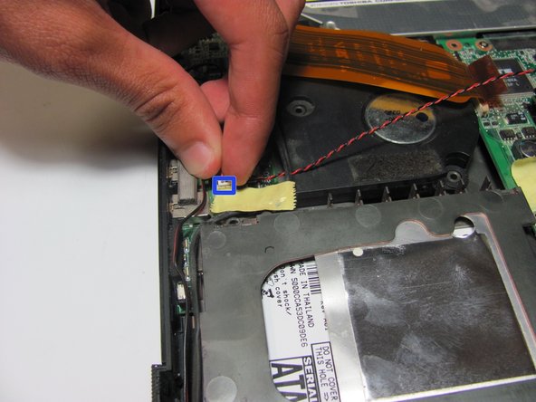

  15. Asus W2W-A1 Speaker Replacement: crwdns2935265:015crwdnd2935265:01crwdnd2935265:02crwdne2935265:0 Asus W2W-A1 Speaker Replacement: crwdns2935265:015crwdnd2935265:02crwdnd2935265:02crwdne2935265:0
    • Grab the cable by the white connection to the laptop, and gently pull to disconnect.
