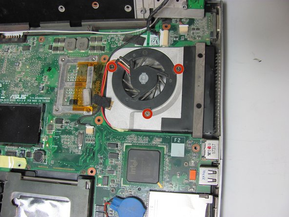

  13. Asus W2W-A1 Fan Replacement, Fan: crwdns2935265:013crwdnd2935265:01crwdnd2935265:02crwdne2935265:0 Asus W2W-A1 Fan Replacement, Fan: crwdns2935265:013crwdnd2935265:02crwdnd2935265:02crwdne2935265:0
    • Remove the 3 4 mm Phillips head screws holding down the fan on inside of the laptop.

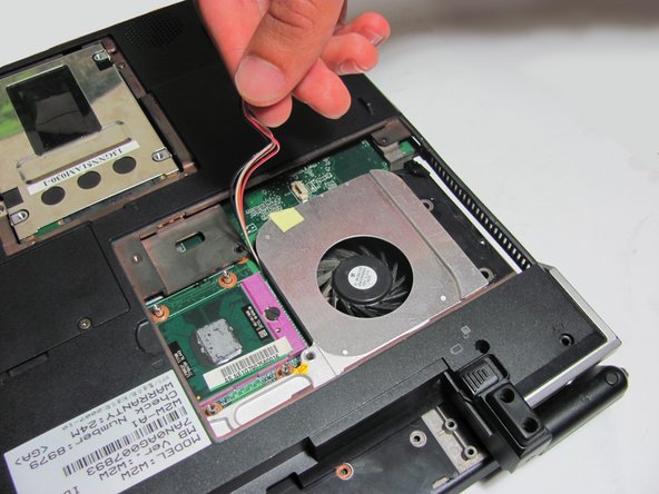

  14. Asus W2W-A1 Fan Replacement: crwdns2935265:014crwdnd2935265:01crwdnd2935265:01crwdne2935265:0
    • Remove the 4 mm Phillips head screw holding the left panel on the back of the laptop.
    • Slide off the left panel by pulling to the left.

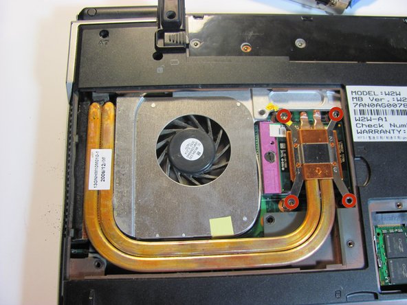

  15. Asus W2W-A1 Fan Replacement: crwdns2935265:015crwdnd2935265:01crwdnd2935265:02crwdne2935265:0 Asus W2W-A1 Fan Replacement: crwdns2935265:015crwdnd2935265:02crwdnd2935265:02crwdne2935265:0
    • Remove the 4 4 mm Phillips screws on the orange cooling system.
  16. Asus W2W-A1 Fan Replacement: crwdns2935265:016crwdnd2935265:01crwdnd2935265:01crwdne2935265:0
    • Gently lift the orange cooling system upward to remove it from the laptop.
  17. Asus W2W-A1 Fan Replacement: crwdns2935265:017crwdnd2935265:01crwdnd2935265:02crwdne2935265:0 Asus W2W-A1 Fan Replacement: crwdns2935265:017crwdnd2935265:02crwdnd2935265:02crwdne2935265:0
    • Disconnect the cable from its socket by pulling up on it gently. It will be revealed beneath the previously removed cooling system.

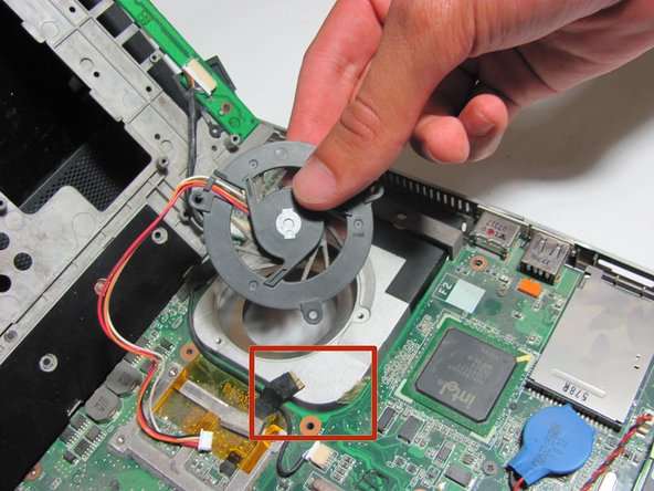

  18. Asus W2W-A1 Fan Replacement: crwdns2935265:018crwdnd2935265:01crwdnd2935265:02crwdne2935265:0 Asus W2W-A1 Fan Replacement: crwdns2935265:018crwdnd2935265:02crwdnd2935265:02crwdne2935265:0
    • From the front of the laptop, remove the tape holding down the fan's cable.
    • Gently push down on the protective area around the fan as shown to pull the cable through the gap created.
    • Lift the fan out of the laptop.
