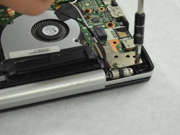

  4. Asus Vivobook S500CA Screen Hinges Replacement: crwdns2935265:04crwdnd2935265:01crwdnd2935265:02crwdne2935265:0 Asus Vivobook S500CA Screen Hinges Replacement: crwdns2935265:04crwdnd2935265:02crwdnd2935265:02crwdne2935265:0
    • Remove 3 (.5 cm) phillips screws around the edge of the hinge. Repeat for other side.
  5. Asus Vivobook S500CA Screen Hinges Replacement: crwdns2935265:05crwdnd2935265:01crwdnd2935265:01crwdne2935265:0
    • Disconnect the black and white wires from the “Aux” (white) and “Main” (black) ports

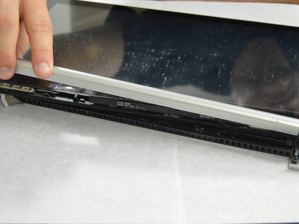

  6. Asus Vivobook S500CA Screen Hinges Replacement: crwdns2935265:06crwdnd2935265:01crwdnd2935265:02crwdne2935265:0 Asus Vivobook S500CA Screen Hinges Replacement: crwdns2935265:06crwdnd2935265:02crwdnd2935265:02crwdne2935265:0
    • Open the device to access the plastic casing over the hinges.
    • Remove the casing by lifting firmly. This step can be difficult.
  7. Asus Vivobook S500CA Screen Hinges Replacement: crwdns2935265:07crwdnd2935265:01crwdnd2935265:02crwdne2935265:0 Asus Vivobook S500CA Screen Hinges Replacement: crwdns2935265:07crwdnd2935265:02crwdnd2935265:02crwdne2935265:0
    • Remove 4 (.5 cm) screws from the hinge. Remove the hinge and follow steps in reverse order to reassemble and complete repair.
