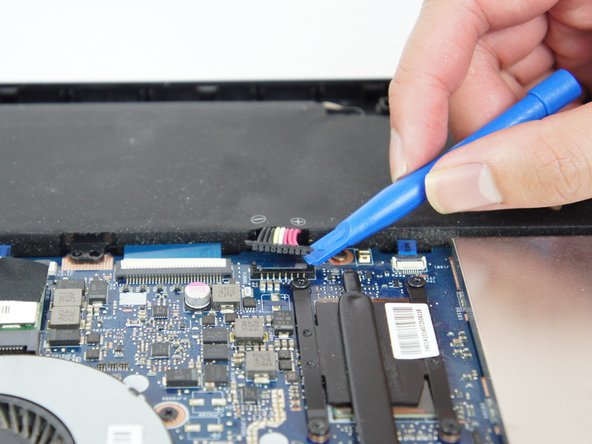

  4. Asus Vivobook Q302LA-BHI3T09 Battery Replacement: crwdns2935265:04crwdnd2935265:01crwdnd2935265:02crwdne2935265:0 Asus Vivobook Q302LA-BHI3T09 Battery Replacement: crwdns2935265:04crwdnd2935265:02crwdnd2935265:02crwdne2935265:0
    • Disconnect the cable connected to the motherboard.
    • To remove, lift the ends using the opening tool.
