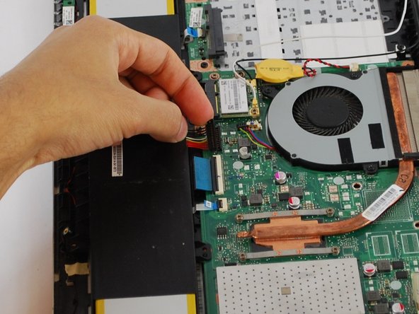

  5. Asus Vivobook Q301LA-BHI5T02 Track Pad Replacement, Battery: crwdns2935265:05crwdnd2935265:01crwdnd2935265:02crwdne2935265:0 Asus Vivobook Q301LA-BHI5T02 Track Pad Replacement, Battery: crwdns2935265:05crwdnd2935265:02crwdnd2935265:02crwdne2935265:0
    • Using a Phillips #1 Screwdriver remove the six 3 mm screws keeping the battery in place.
  6. Asus Vivobook Q301LA-BHI5T02 Track Pad Replacement: crwdns2935265:06crwdnd2935265:01crwdnd2935265:02crwdne2935265:0 Asus Vivobook Q301LA-BHI5T02 Track Pad Replacement: crwdns2935265:06crwdnd2935265:02crwdnd2935265:02crwdne2935265:0
    • Unplug the battery connector from the mother board.
  7. Asus Vivobook Q301LA-BHI5T02 Track Pad Replacement: crwdns2935265:07crwdnd2935265:01crwdnd2935265:02crwdne2935265:0 Asus Vivobook Q301LA-BHI5T02 Track Pad Replacement: crwdns2935265:07crwdnd2935265:02crwdnd2935265:02crwdne2935265:0
    • Gently remove the battery from the slot.

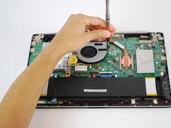

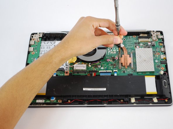

  8. Asus Vivobook Q301LA-BHI5T02 Track Pad Replacement, Fan and Heatsink: crwdns2935265:08crwdnd2935265:01crwdnd2935265:03crwdne2935265:0 Asus Vivobook Q301LA-BHI5T02 Track Pad Replacement, Fan and Heatsink: crwdns2935265:08crwdnd2935265:02crwdnd2935265:03crwdne2935265:0 Asus Vivobook Q301LA-BHI5T02 Track Pad Replacement, Fan and Heatsink: crwdns2935265:08crwdnd2935265:03crwdnd2935265:03crwdne2935265:0
    • Using a Phillips #1 Screwdriver remove the three 3 mm black screws and four 2 mm copper screws holding the fan and heat sink in place.

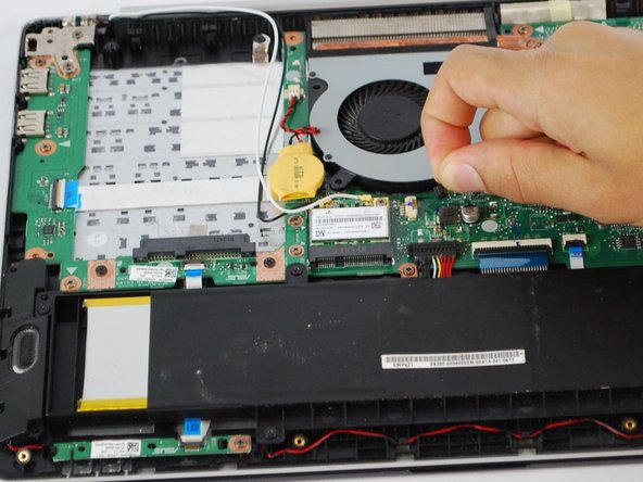

  9. Asus Vivobook Q301LA-BHI5T02 Track Pad Replacement: crwdns2935265:09crwdnd2935265:01crwdnd2935265:02crwdne2935265:0 Asus Vivobook Q301LA-BHI5T02 Track Pad Replacement: crwdns2935265:09crwdnd2935265:02crwdnd2935265:02crwdne2935265:0
    • Remove the wire connecting the fan to the motherboard.
  10. Asus Vivobook Q301LA-BHI5T02 Track Pad Replacement: crwdns2935265:010crwdnd2935265:01crwdnd2935265:02crwdne2935265:0 Asus Vivobook Q301LA-BHI5T02 Track Pad Replacement: crwdns2935265:010crwdnd2935265:02crwdnd2935265:02crwdne2935265:0
    • Gently remove the fan and heat sink from the motherboard.

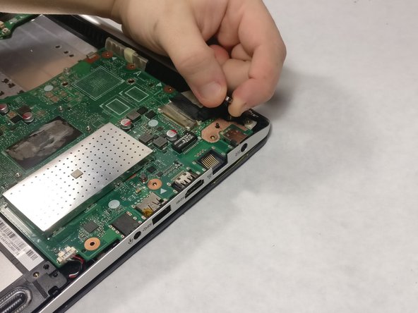

  13. Asus Vivobook Q301LA-BHI5T02 Track Pad Replacement: crwdns2935265:013crwdnd2935265:01crwdnd2935265:01crwdne2935265:0
    • Disconnect the motherboard from the two connectors shown.
  14. Asus Vivobook Q301LA-BHI5T02 Track Pad Replacement: crwdns2935265:014crwdnd2935265:01crwdnd2935265:01crwdne2935265:0
    • Disconnect the motherboard from the connector shown.
  15. Asus Vivobook Q301LA-BHI5T02 Track Pad Replacement: crwdns2935265:015crwdnd2935265:01crwdnd2935265:01crwdne2935265:0
    • Pull the motherboard loose.
  16. Asus Vivobook Q301LA-BHI5T02 Track Pad Replacement: crwdns2935265:016crwdnd2935265:01crwdnd2935265:01crwdne2935265:0
    • Disconnect the motherboard from the connector shown and it is now removed from your device.
