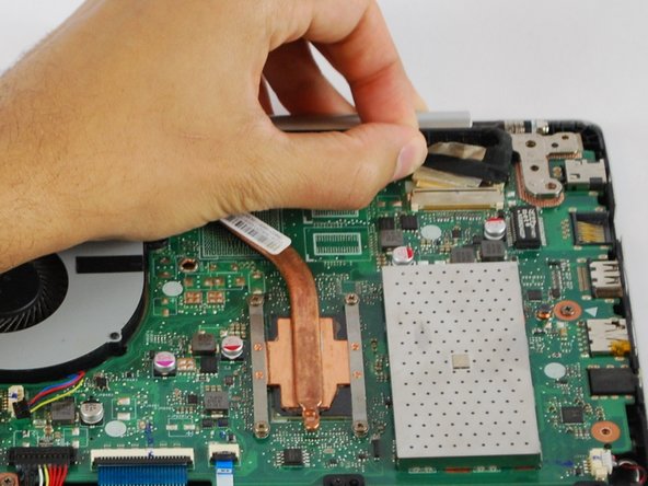

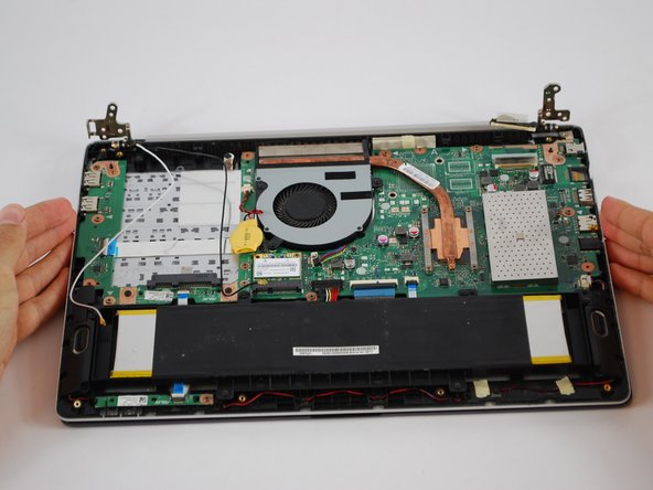

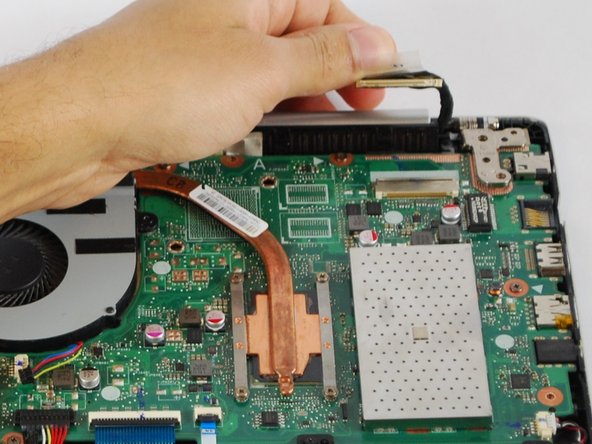

    • Unplug the screen connector from the motherboard.
  6. Asus Vivobook Q301LA-BHI5T02 Screen Replacement: crwdns2935265:06crwdnd2935265:01crwdnd2935265:02crwdne2935265:0 Asus Vivobook Q301LA-BHI5T02 Screen Replacement: crwdns2935265:06crwdnd2935265:02crwdnd2935265:02crwdne2935265:0

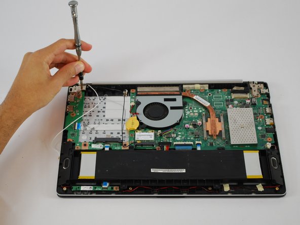

    • Using a Phillips #1 Screwdriver unscrew the four 4 mm screws holding the screen holder onto the motherboard.
  7. Asus Vivobook Q301LA-BHI5T02 Screen Replacement: crwdns2935265:07crwdnd2935265:01crwdnd2935265:03crwdne2935265:0 Asus Vivobook Q301LA-BHI5T02 Screen Replacement: crwdns2935265:07crwdnd2935265:02crwdnd2935265:03crwdne2935265:0 Asus Vivobook Q301LA-BHI5T02 Screen Replacement: crwdns2935265:07crwdnd2935265:03crwdnd2935265:03crwdne2935265:0

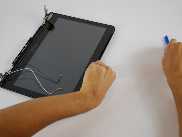

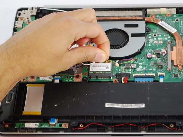

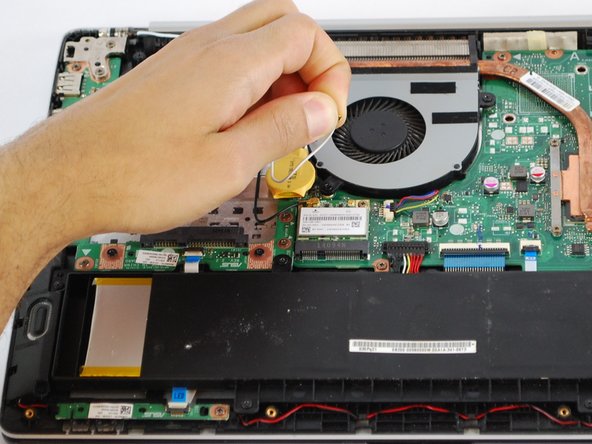

    • Remove the two cables connecting to the wifi card.
  8. Asus Vivobook Q301LA-BHI5T02 Screen Replacement: crwdns2935265:08crwdnd2935265:01crwdnd2935265:03crwdne2935265:0 Asus Vivobook Q301LA-BHI5T02 Screen Replacement: crwdns2935265:08crwdnd2935265:02crwdnd2935265:03crwdne2935265:0 Asus Vivobook Q301LA-BHI5T02 Screen Replacement: crwdns2935265:08crwdnd2935265:03crwdnd2935265:03crwdne2935265:0
    • Remove the screen holder from the rest of the laptop.
    • Make sure when removing screen cover lift bottom of the laptop to about a 45° degree angle when removing it.

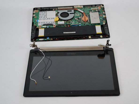

  9. Asus Vivobook Q301LA-BHI5T02 Screen Replacement: crwdns2935265:09crwdnd2935265:01crwdnd2935265:02crwdne2935265:0 Asus Vivobook Q301LA-BHI5T02 Screen Replacement: crwdns2935265:09crwdnd2935265:02crwdnd2935265:02crwdne2935265:0
    • Remove the bottom of the laptop from the screen.

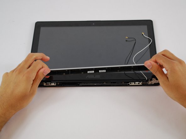

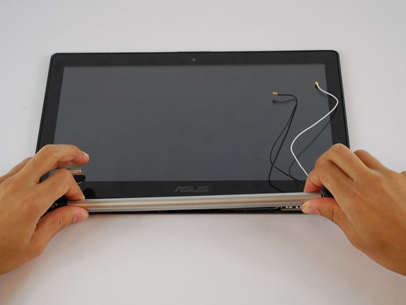

    • Remove the hinge cover by gently pulling to the right then upwards.
  11. Asus Vivobook Q301LA-BHI5T02 Screen Replacement: crwdns2935265:011crwdnd2935265:01crwdnd2935265:01crwdne2935265:0
    • Using a Phillips #1 Screwdriver unscrew the six 3 mm black screws and the three 2 mm copper screws that are keeping the screen in place.
    • Keep track of what screws go where.

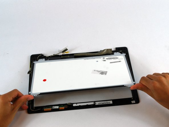

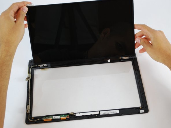

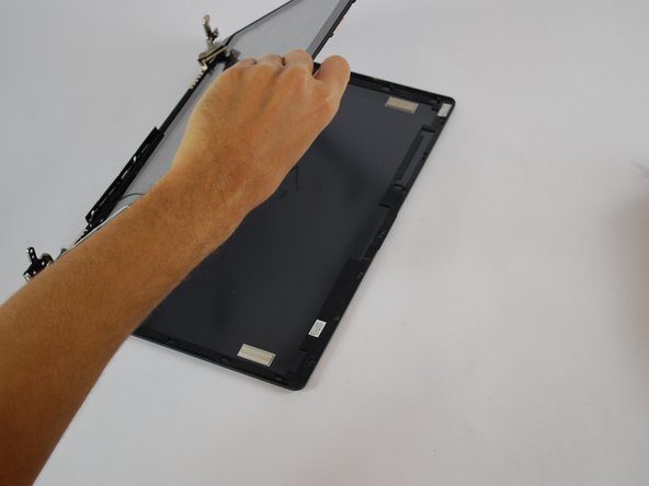

    • Push screen downwards then pull top of screen upwards and remove the screen.
  13. Asus Vivobook Q301LA-BHI5T02 Screen Replacement: crwdns2935265:013crwdnd2935265:01crwdnd2935265:02crwdne2935265:0 Asus Vivobook Q301LA-BHI5T02 Screen Replacement: crwdns2935265:013crwdnd2935265:02crwdnd2935265:02crwdne2935265:0

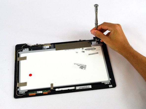

    • Using a Phillips #1 Screwdriver Unscrew the four 2 mm screws holding the screen onto the screen cover.
    • Use the PH0 bit screwdriver to unscrew the screws.
  14. Asus Vivobook Q301LA-BHI5T02 Screen Replacement: crwdns2935265:014crwdnd2935265:01crwdnd2935265:03crwdne2935265:0 Asus Vivobook Q301LA-BHI5T02 Screen Replacement: crwdns2935265:014crwdnd2935265:02crwdnd2935265:03crwdne2935265:0 Asus Vivobook Q301LA-BHI5T02 Screen Replacement: crwdns2935265:014crwdnd2935265:03crwdnd2935265:03crwdne2935265:0

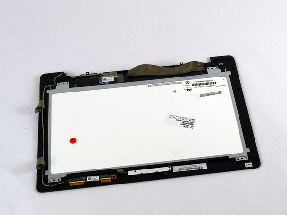

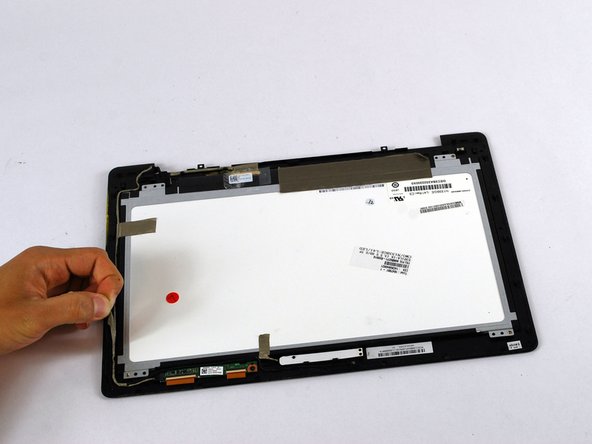

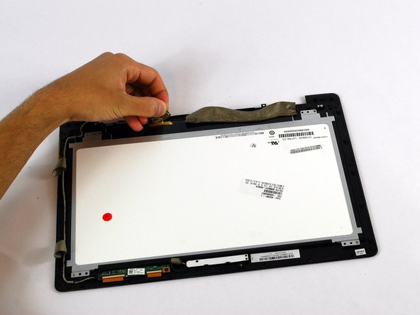

    • Use a sharp object to remove tape from the back of the screen.
    • Careful when cutting the tape off, you can accidentally cut a wire
  15. Asus Vivobook Q301LA-BHI5T02 Screen Replacement: crwdns2935265:015crwdnd2935265:01crwdnd2935265:03crwdne2935265:0 Asus Vivobook Q301LA-BHI5T02 Screen Replacement: crwdns2935265:015crwdnd2935265:02crwdnd2935265:03crwdne2935265:0 Asus Vivobook Q301LA-BHI5T02 Screen Replacement: crwdns2935265:015crwdnd2935265:03crwdnd2935265:03crwdne2935265:0
    • Unplug the screen from the screen holder.
    • Don't pull the cable too hard or it can damage the connection.
  16. Asus Vivobook Q301LA-BHI5T02 Screen Replacement: crwdns2935265:016crwdnd2935265:01crwdnd2935265:03crwdne2935265:0 Asus Vivobook Q301LA-BHI5T02 Screen Replacement: crwdns2935265:016crwdnd2935265:02crwdnd2935265:03crwdne2935265:0 Asus Vivobook Q301LA-BHI5T02 Screen Replacement: crwdns2935265:016crwdnd2935265:03crwdnd2935265:03crwdne2935265:0
    • Take the screen off of the screen holder.
