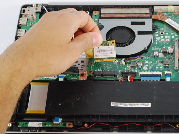

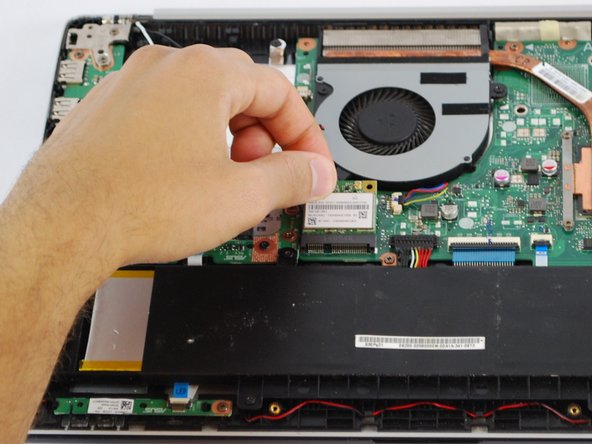

  8. Asus Vivobook Q301LA-BHI5T02 Motherboard Replacement, Wifi card: crwdns2935265:08crwdnd2935265:01crwdnd2935265:03crwdne2935265:0 Asus Vivobook Q301LA-BHI5T02 Motherboard Replacement, Wifi card: crwdns2935265:08crwdnd2935265:02crwdnd2935265:03crwdne2935265:0 Asus Vivobook Q301LA-BHI5T02 Motherboard Replacement, Wifi card: crwdns2935265:08crwdnd2935265:03crwdnd2935265:03crwdne2935265:0
    • Unplug the two small cords connected to the wifi card.
  9. Asus Vivobook Q301LA-BHI5T02 Motherboard Replacement: crwdns2935265:09crwdnd2935265:01crwdnd2935265:01crwdne2935265:0
    • Using a Phillips #1 Screwdriver unscrew the 2 mm screw holding the wifi card in place.
  10. Asus Vivobook Q301LA-BHI5T02 Motherboard Replacement: crwdns2935265:010crwdnd2935265:01crwdnd2935265:03crwdne2935265:0 Asus Vivobook Q301LA-BHI5T02 Motherboard Replacement: crwdns2935265:010crwdnd2935265:02crwdnd2935265:03crwdne2935265:0 Asus Vivobook Q301LA-BHI5T02 Motherboard Replacement: crwdns2935265:010crwdnd2935265:03crwdnd2935265:03crwdne2935265:0
    • Unplug the Wi-Fi card from the motherboard and remove it from the device.

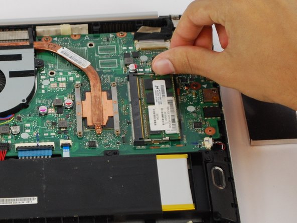

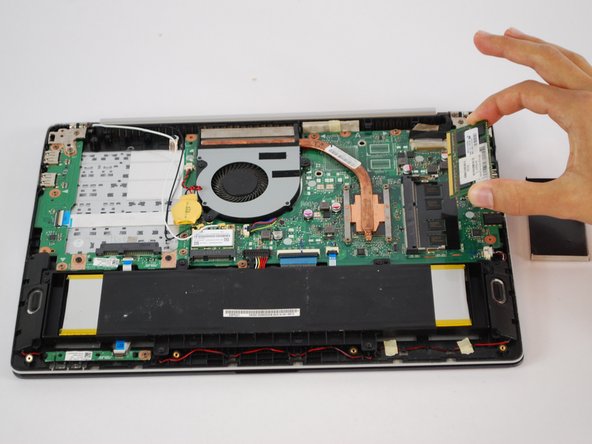

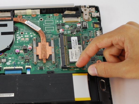

  14. Asus Vivobook Q301LA-BHI5T02 Motherboard Replacement, RAM: crwdns2935265:014crwdnd2935265:01crwdnd2935265:03crwdne2935265:0 Asus Vivobook Q301LA-BHI5T02 Motherboard Replacement, RAM: crwdns2935265:014crwdnd2935265:02crwdnd2935265:03crwdne2935265:0 Asus Vivobook Q301LA-BHI5T02 Motherboard Replacement, RAM: crwdns2935265:014crwdnd2935265:03crwdnd2935265:03crwdne2935265:0
    • Remove the top covering the RAM chips.
  15. Asus Vivobook Q301LA-BHI5T02 Motherboard Replacement: crwdns2935265:015crwdnd2935265:01crwdnd2935265:03crwdne2935265:0 Asus Vivobook Q301LA-BHI5T02 Motherboard Replacement: crwdns2935265:015crwdnd2935265:02crwdnd2935265:03crwdne2935265:0 Asus Vivobook Q301LA-BHI5T02 Motherboard Replacement: crwdns2935265:015crwdnd2935265:03crwdnd2935265:03crwdne2935265:0
    • Gently push the RAM chip holder to the sides.
  16. Asus Vivobook Q301LA-BHI5T02 Motherboard Replacement: crwdns2935265:016crwdnd2935265:01crwdnd2935265:03crwdne2935265:0 Asus Vivobook Q301LA-BHI5T02 Motherboard Replacement: crwdns2935265:016crwdnd2935265:02crwdnd2935265:03crwdne2935265:0 Asus Vivobook Q301LA-BHI5T02 Motherboard Replacement: crwdns2935265:016crwdnd2935265:03crwdnd2935265:03crwdne2935265:0
    • Remove the RAM from the device.
