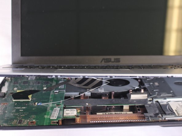

  3. Asus Vivobook Max X541SA-PD0703X Wi - Fi Card Replacement: crwdns2935265:03crwdnd2935265:01crwdnd2935265:02crwdne2935265:0 Asus Vivobook Max X541SA-PD0703X Wi - Fi Card Replacement: crwdns2935265:03crwdnd2935265:02crwdnd2935265:02crwdne2935265:0
    • Using a plastic opening tool, pry up the palm rest from the bottom half of the laptop.
    • Ribbon cables still connect both halves so don't remove completely.

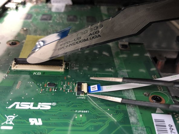

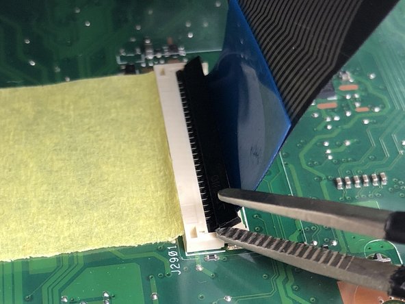

  4. Asus Vivobook Max X541SA-PD0703X Wi - Fi Card Replacement: crwdns2935265:04crwdnd2935265:01crwdnd2935265:03crwdne2935265:0 Asus Vivobook Max X541SA-PD0703X Wi - Fi Card Replacement: crwdns2935265:04crwdnd2935265:02crwdnd2935265:03crwdne2935265:0 Asus Vivobook Max X541SA-PD0703X Wi - Fi Card Replacement: crwdns2935265:04crwdnd2935265:03crwdnd2935265:03crwdne2935265:0
    • Use a spudger to flip up the retaining flap on the keyboard ribbon cable ZIF sockets.
    • Pull the ribbon cables out of their sockets.
