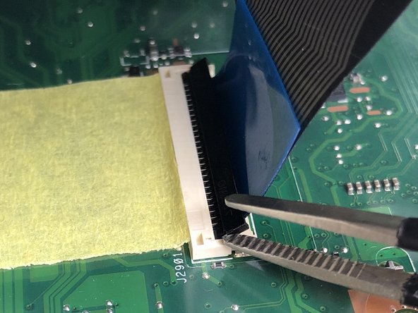

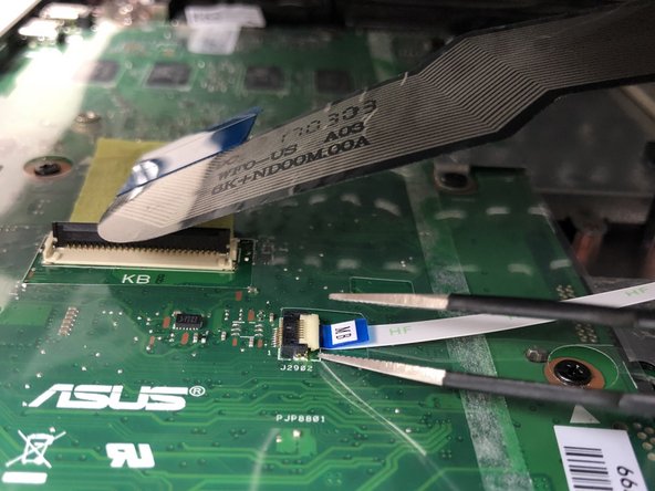

    • Use a spudger to flip up the retaining flaps on both keyboard ribbon cable ZIF sockets.
    • Pull the ribbon cables out of their sockets.

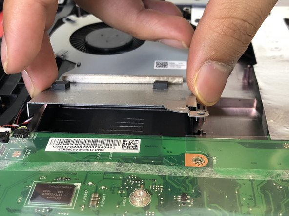

  10. Asus Vivobook Max X541SA-PD0703X Motherboard Replacement: crwdns2935265:010crwdnd2935265:01crwdnd2935265:01crwdne2935265:0
    • Pull the metal casing to the right.
    • Be careful when pulling the case because it may break the motherboard.

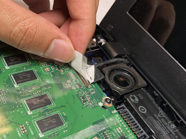

    • There is a wire attached to the screen display.
    • Peel the sticker and disconnect it from the motherboard.

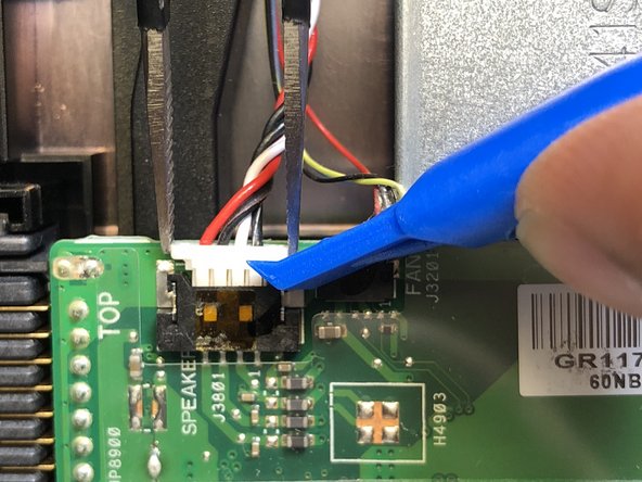

    • Remove the cables connected to the motherboard by unplugging them using a plastic opening tool, or by hand.
