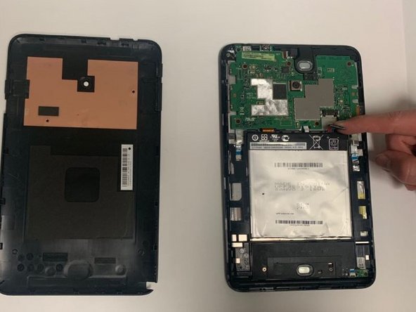

    • Remove the pen and memory card if you have them; they may get in the way when you are opening the device.
    • Pry open the edges of the cover using the plastic opening tool. The memory card slot is very useful for getting started.
  2. Asus VivoTab Note 8 Battery Replacement: crwdns2935265:02crwdnd2935265:01crwdnd2935265:02crwdne2935265:0 Asus VivoTab Note 8 Battery Replacement: crwdns2935265:02crwdnd2935265:02crwdnd2935265:02crwdne2935265:0
    • Move the opening tool along the edges of the tablet and push up wherever you can. You may need to open up all of the sides to take the panel off.
    • Pull apart the sides of the casing by hand.
  3. Asus VivoTab Note 8 Battery Replacement: crwdns2935265:03crwdnd2935265:01crwdnd2935265:01crwdne2935265:0
    • After pulling the panel off, put it to the side.
  4. Asus VivoTab Note 8 Battery Replacement, Battery: crwdns2935265:04crwdnd2935265:01crwdnd2935265:02crwdne2935265:0 Asus VivoTab Note 8 Battery Replacement, Battery: crwdns2935265:04crwdnd2935265:02crwdnd2935265:02crwdne2935265:0
    • Disconnect the battery from the motherboard by pulling the side of the black plastic up.
  5. Asus VivoTab Note 8 Battery Replacement: crwdns2935265:05crwdnd2935265:01crwdnd2935265:02crwdne2935265:0 Asus VivoTab Note 8 Battery Replacement: crwdns2935265:05crwdnd2935265:02crwdnd2935265:02crwdne2935265:0
    • Use a plastic opening tool to pry up the battery.
    • Be careful not to tear the battery; it is very hard to pull up the battery so go slowly.
    • After the tape is loose take the battery out.
To reassemble your device, follow these instructions in reverse order. You will need adhesive to keep the battery stuck if the tape stops working.
