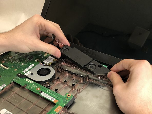

  16. Asus VivoBook X540SA-BPD0602V Speaker Replacement, Speaker: crwdns2935265:016crwdnd2935265:01crwdnd2935265:02crwdne2935265:0 Asus VivoBook X540SA-BPD0602V Speaker Replacement, Speaker: crwdns2935265:016crwdnd2935265:02crwdnd2935265:02crwdne2935265:0
    • Disconnect speaker wire from motherboard.
  17. Asus VivoBook X540SA-BPD0602V Speaker Replacement: crwdns2935265:017crwdnd2935265:01crwdnd2935265:03crwdne2935265:0 Asus VivoBook X540SA-BPD0602V Speaker Replacement: crwdns2935265:017crwdnd2935265:02crwdnd2935265:03crwdne2935265:0 Asus VivoBook X540SA-BPD0602V Speaker Replacement: crwdns2935265:017crwdnd2935265:03crwdnd2935265:03crwdne2935265:0
    • Gently use the metal spudger to loosen speaker from adhesive, by first loosening the far right side and working your way to the left.
    • When removing the speaker, you may hear a cracking sound. This is okay; it is just the speaker separating from the adhesive.
