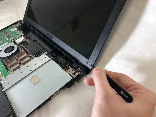

  8. Asus VivoBook X540SA-BPD0602V Display Replacement, Display: crwdns2935265:08crwdnd2935265:01crwdnd2935265:02crwdne2935265:0 Asus VivoBook X540SA-BPD0602V Display Replacement, Display: crwdns2935265:08crwdnd2935265:02crwdnd2935265:02crwdne2935265:0
    • Use tweezers to remove small plastic screw covers from the bottom corners of the screen.

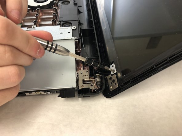

  9. Asus VivoBook X540SA-BPD0602V Display Replacement: crwdns2935265:09crwdnd2935265:01crwdnd2935265:01crwdne2935265:0
    • Using the Phillips #0 screwdriver, remove the screws (3.8mm) from the bottom corners of the screen.

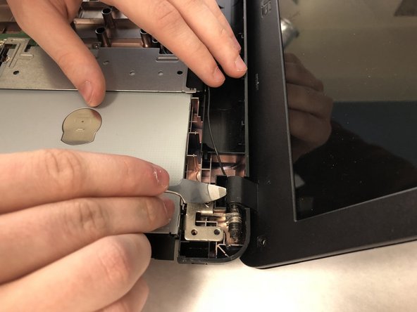

  10. Asus VivoBook X540SA-BPD0602V Display Replacement: crwdns2935265:010crwdnd2935265:01crwdnd2935265:02crwdne2935265:0 Asus VivoBook X540SA-BPD0602V Display Replacement: crwdns2935265:010crwdnd2935265:02crwdnd2935265:02crwdne2935265:0
    • Gently go around the screen and pry the plastic frame away with the metal spudger.
    • Before disconnecting the bottom edge of the plastic frame, be sure to disconnect it from the laptop's hinges.
    • Be careful with the metal spudger in this process--it is easy to cause damage to the device with this tool.
  11. Asus VivoBook X540SA-BPD0602V Display Replacement: crwdns2935265:011crwdnd2935265:01crwdnd2935265:02crwdne2935265:0 Asus VivoBook X540SA-BPD0602V Display Replacement: crwdns2935265:011crwdnd2935265:02crwdnd2935265:02crwdne2935265:0
    • Remove screws (3.5mm) from the four corners of the screen, utilizing Phillips #0 screwdriver.
