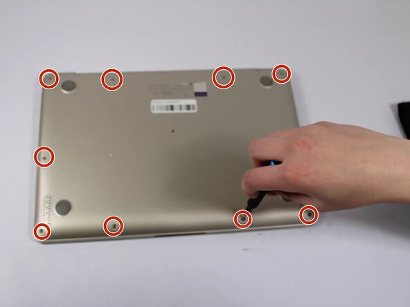

  1. Asus VivoBook S14 Speakers Replacement, Back Panel: crwdns2935265:01crwdnd2935265:01crwdnd2935265:02crwdne2935265:0 Asus VivoBook S14 Speakers Replacement, Back Panel: crwdns2935265:01crwdnd2935265:02crwdnd2935265:02crwdne2935265:0
    • Remove all eleven 5 mm screws on the back panel with a JIS #000 screwdriver.
    • Gently pry off the back cover.

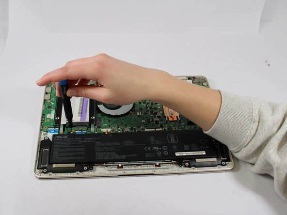

  3. Asus VivoBook S14 Speakers Replacement: crwdns2935265:03crwdnd2935265:01crwdnd2935265:02crwdne2935265:0 Asus VivoBook S14 Speakers Replacement: crwdns2935265:03crwdnd2935265:02crwdnd2935265:02crwdne2935265:0
    • Remove the 5 mm screws holding the battery in place with a JIS #000 screwdriver.
  4. Asus VivoBook S14 Speakers Replacement: crwdns2935265:04crwdnd2935265:01crwdnd2935265:02crwdne2935265:0 Asus VivoBook S14 Speakers Replacement: crwdns2935265:04crwdnd2935265:02crwdnd2935265:02crwdne2935265:0
    • Lift the battery out of the battery socket.

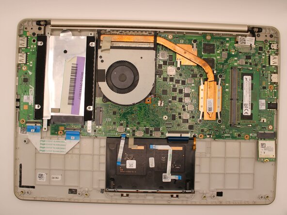

  5. Asus VivoBook S14 Speakers Replacement, Speakers: crwdns2935265:05crwdnd2935265:01crwdnd2935265:01crwdne2935265:0
    • Remove a total of five 5 mm JIS #000 screws from the speakers.
  6. Asus VivoBook S14 Speakers Replacement: crwdns2935265:06crwdnd2935265:01crwdnd2935265:01crwdne2935265:0
    • Detach the speaker connector from the motherboard.

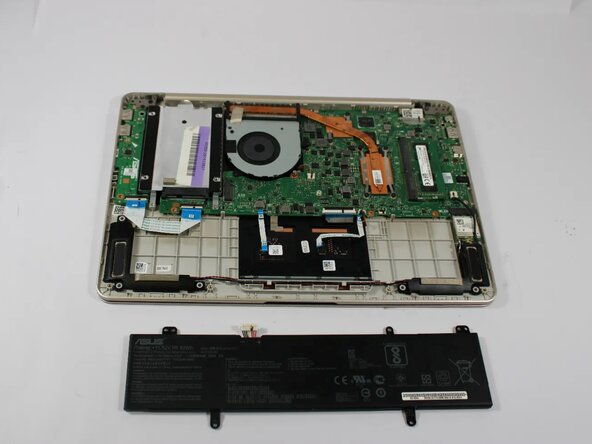

  7. Asus VivoBook S14 Speakers Replacement: crwdns2935265:07crwdnd2935265:01crwdnd2935265:01crwdne2935265:0
    • Lift the right speaker out of the computer.
  8. Asus VivoBook S14 Speakers Replacement: crwdns2935265:08crwdnd2935265:01crwdnd2935265:01crwdne2935265:0
    • Carefully remove the wires connecting the speakers to each other from the computer.
  9. Asus VivoBook S14 Speakers Replacement: crwdns2935265:09crwdnd2935265:01crwdnd2935265:02crwdne2935265:0 Asus VivoBook S14 Speakers Replacement: crwdns2935265:09crwdnd2935265:02crwdnd2935265:02crwdne2935265:0
    • Lift the left speaker out of the computer.
