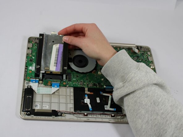

  5. Asus VivoBook S14 Motherboard Replacement, Motherboard: crwdns2935265:05crwdnd2935265:01crwdnd2935265:02crwdne2935265:0 Asus VivoBook S14 Motherboard Replacement, Motherboard: crwdns2935265:05crwdnd2935265:02crwdnd2935265:02crwdne2935265:0

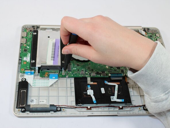

    • Use the JIS #000 screwdriver to remove the 5mm screws holding the hard drive into place.
  6. Asus VivoBook S14 Motherboard Replacement: crwdns2935265:06crwdnd2935265:01crwdnd2935265:03crwdne2935265:0 Asus VivoBook S14 Motherboard Replacement: crwdns2935265:06crwdnd2935265:02crwdnd2935265:03crwdne2935265:0 Asus VivoBook S14 Motherboard Replacement: crwdns2935265:06crwdnd2935265:03crwdnd2935265:03crwdne2935265:0
    • Gently remove the hard drive by pulling up from the motherboard and out.
    • Set aside.

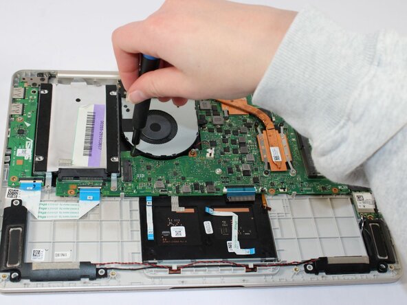

  7. Asus VivoBook S14 Motherboard Replacement: crwdns2935265:07crwdnd2935265:01crwdnd2935265:01crwdne2935265:0
    • Disconnect the fan connector from the motherboard.

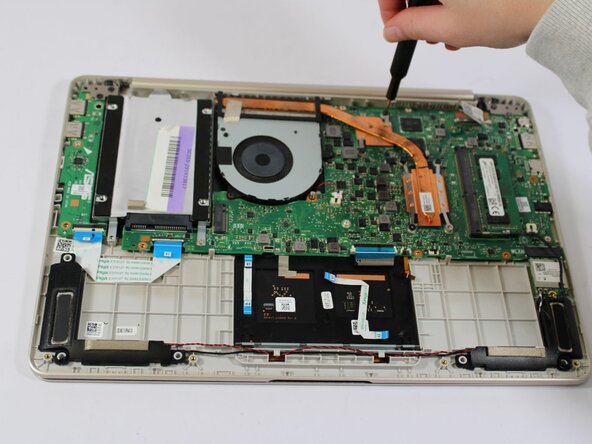

  8. Asus VivoBook S14 Motherboard Replacement: crwdns2935265:08crwdnd2935265:01crwdnd2935265:03crwdne2935265:0 Asus VivoBook S14 Motherboard Replacement: crwdns2935265:08crwdnd2935265:02crwdnd2935265:03crwdne2935265:0 Asus VivoBook S14 Motherboard Replacement: crwdns2935265:08crwdnd2935265:03crwdnd2935265:03crwdne2935265:0
    • Remove all eight of the 5 mm screws from the fan and heat sink using a JIS #000 screwdriver.

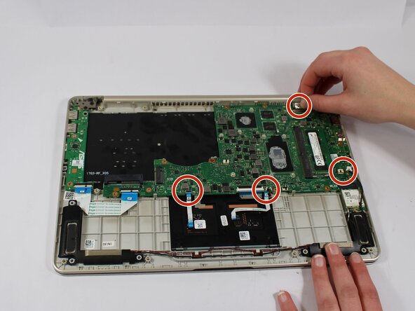

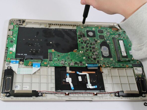

    • Remove ten 5 mm screws that hold the motherboard into place with a JIS #000 screwdriver.
  12. Asus VivoBook S14 Motherboard Replacement: crwdns2935265:012crwdnd2935265:01crwdnd2935265:02crwdne2935265:0 Asus VivoBook S14 Motherboard Replacement: crwdns2935265:012crwdnd2935265:02crwdnd2935265:02crwdne2935265:0

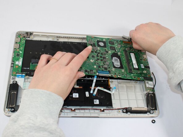

    • Gently lift the motherboard out of its compartment.
