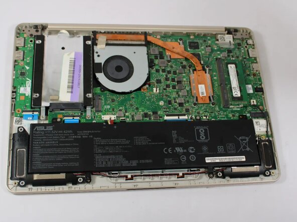

  1. Asus VivoBook S14 Fan and Heat Sink Replacement, Back Panel: crwdns2935265:01crwdnd2935265:01crwdnd2935265:02crwdne2935265:0 Asus VivoBook S14 Fan and Heat Sink Replacement, Back Panel: crwdns2935265:01crwdnd2935265:02crwdnd2935265:02crwdne2935265:0
    • Remove all eleven 5 mm screws on the back panel with a JIS #000 screwdriver.
    • Gently pry off the back cover.

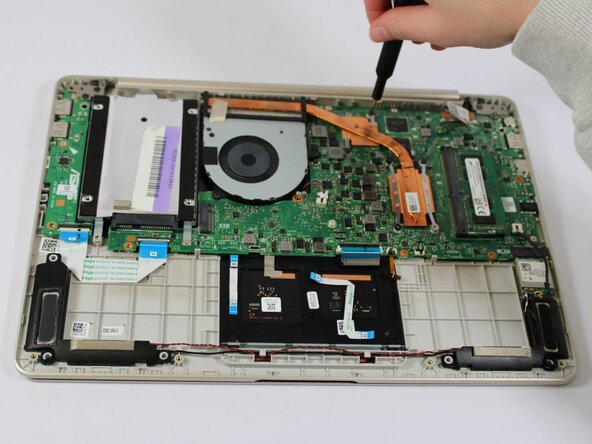

  2. Asus VivoBook S14 Fan and Heat Sink Replacement, Fan and Heat Sink: crwdns2935265:02crwdnd2935265:01crwdnd2935265:02crwdne2935265:0 Asus VivoBook S14 Fan and Heat Sink Replacement, Fan and Heat Sink: crwdns2935265:02crwdnd2935265:02crwdnd2935265:02crwdne2935265:0
    • Detach the fan connector from the motherboard.

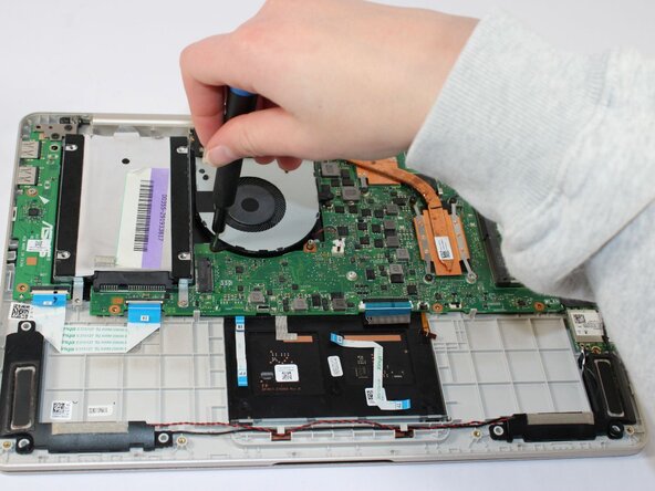

  3. Asus VivoBook S14 Fan and Heat Sink Replacement: crwdns2935265:03crwdnd2935265:01crwdnd2935265:03crwdne2935265:0 Asus VivoBook S14 Fan and Heat Sink Replacement: crwdns2935265:03crwdnd2935265:02crwdnd2935265:03crwdne2935265:0 Asus VivoBook S14 Fan and Heat Sink Replacement: crwdns2935265:03crwdnd2935265:03crwdnd2935265:03crwdne2935265:0
    • Remove the 5 mm screws from the fan using a JIS #000 screwdriver.

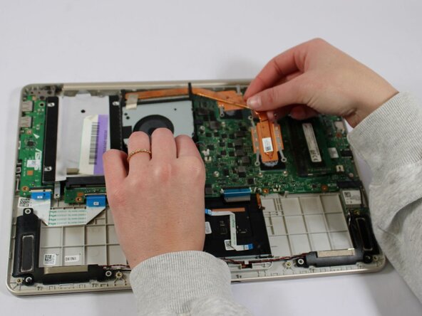

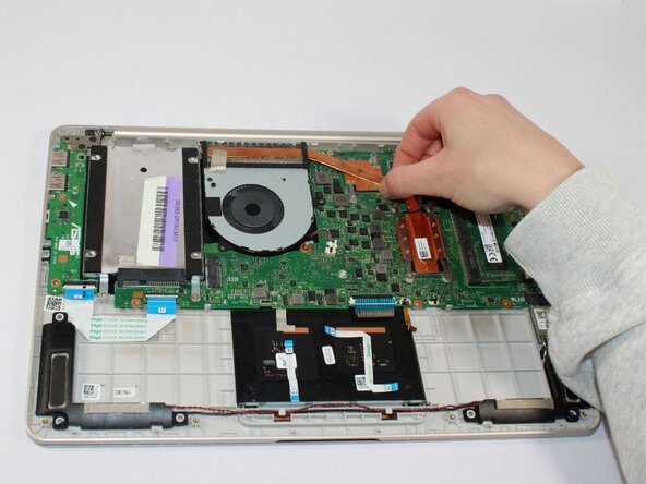

    • Carefully lift out the fan and heat sink from the motherboard.
