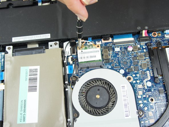

  3. Asus VivoBook Q302LA-BHI3T09 Wi-Fi Chip Replacement: crwdns2935265:03crwdnd2935265:01crwdnd2935265:02crwdne2935265:0 Asus VivoBook Q302LA-BHI3T09 Wi-Fi Chip Replacement: crwdns2935265:03crwdnd2935265:02crwdnd2935265:02crwdne2935265:0
    • Use a JIS #0 Screwdriver to remove the one 3.0 mm screw.

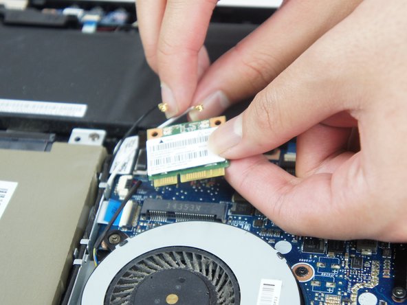

  4. Asus VivoBook Q302LA-BHI3T09 Wi-Fi Chip Replacement: crwdns2935265:04crwdnd2935265:01crwdnd2935265:02crwdne2935265:0 Asus VivoBook Q302LA-BHI3T09 Wi-Fi Chip Replacement: crwdns2935265:04crwdnd2935265:02crwdnd2935265:02crwdne2935265:0
    • Disconnect the black and white wires that provide power and data transfer to the Wi-Fi chip.
