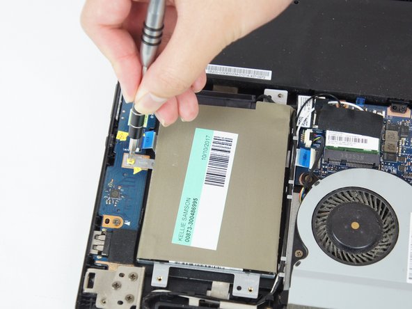

  3. Asus VivoBook Q302LA-BHI3T09 Hard Drive Replacement: crwdns2935265:03crwdnd2935265:01crwdnd2935265:02crwdne2935265:0 Asus VivoBook Q302LA-BHI3T09 Hard Drive Replacement: crwdns2935265:03crwdnd2935265:02crwdnd2935265:02crwdne2935265:0
    • Using the JIS #0 Screwdriver, remove the five 3.0 mm screws that hold down the hard drive casing.

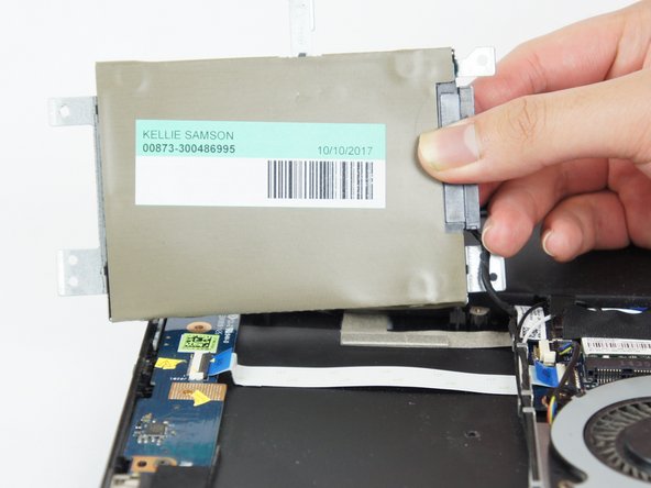

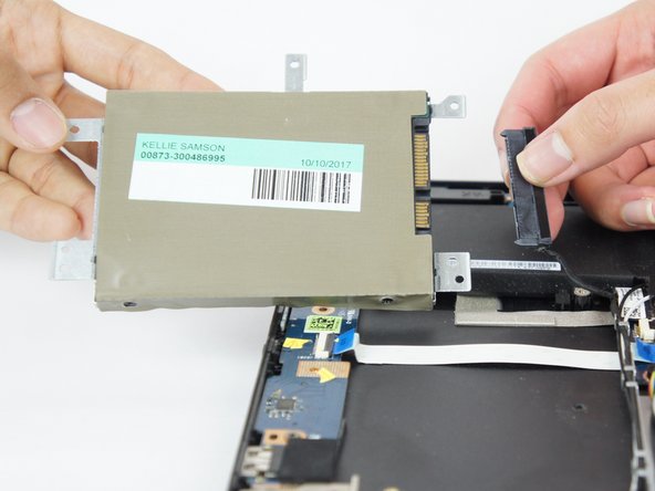

  4. Asus VivoBook Q302LA-BHI3T09 Hard Drive Replacement: crwdns2935265:04crwdnd2935265:01crwdnd2935265:03crwdne2935265:0 Asus VivoBook Q302LA-BHI3T09 Hard Drive Replacement: crwdns2935265:04crwdnd2935265:02crwdnd2935265:03crwdne2935265:0 Asus VivoBook Q302LA-BHI3T09 Hard Drive Replacement: crwdns2935265:04crwdnd2935265:03crwdnd2935265:03crwdne2935265:0
    • Lift the hard drive up and remove the power supply cable connected to it.
    • Make sure to pull on the plastic head and not the actual wires to prevent tearing them.

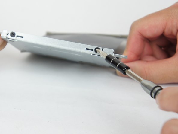

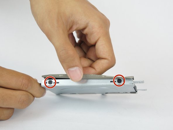

  5. Asus VivoBook Q302LA-BHI3T09 Hard Drive Replacement: crwdns2935265:05crwdnd2935265:01crwdnd2935265:03crwdne2935265:0 Asus VivoBook Q302LA-BHI3T09 Hard Drive Replacement: crwdns2935265:05crwdnd2935265:02crwdnd2935265:03crwdne2935265:0 Asus VivoBook Q302LA-BHI3T09 Hard Drive Replacement: crwdns2935265:05crwdnd2935265:03crwdnd2935265:03crwdne2935265:0
    • Carefully peel back and remove the plastic hard drive cover to reveal the two 3.0 mm screws on the hard drive casing.
    • Using a JIS #0 screwdriver, unscrew the two 3.0 mm screws on the side of the metal casing to remove the hard drive itself.
