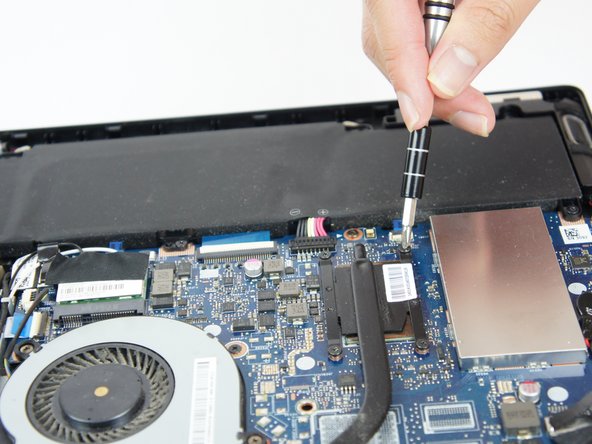

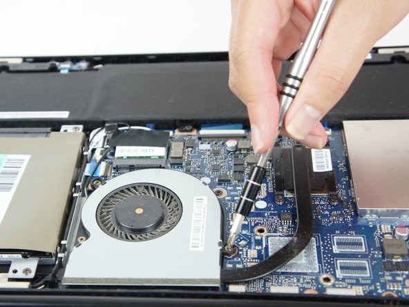

  3. Asus VivoBook Q302LA-BHI3T09 Fan Replacement: crwdns2935265:03crwdnd2935265:01crwdnd2935265:03crwdne2935265:0 Asus VivoBook Q302LA-BHI3T09 Fan Replacement: crwdns2935265:03crwdnd2935265:02crwdnd2935265:03crwdne2935265:0 Asus VivoBook Q302LA-BHI3T09 Fan Replacement: crwdns2935265:03crwdnd2935265:03crwdnd2935265:03crwdne2935265:0
    • Remove the following screws that mount the fan and heatsink to the motherboard:
    • Three 3.0 mm screws for the fan
    • Four 2.0 mm screws for the heatsink
    • The bottom of the heatsink will contain thermal paste. Avoid making contact with this as any dirt or oils can reduce the effectiveness of the cooler.
