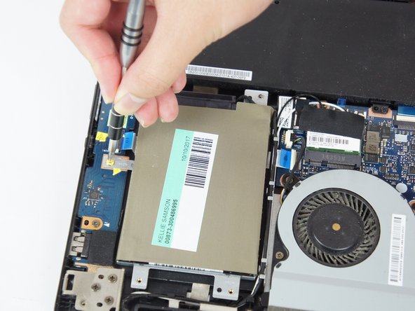

    • Using the JIS #0 Screwdriver, remove the five 3.0 mm screws that hold down the hard drive casing.

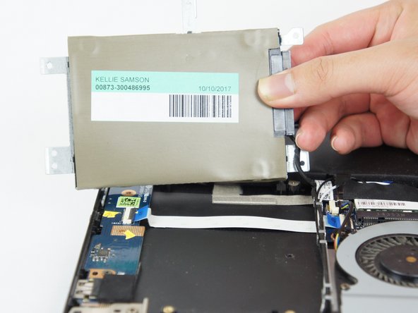

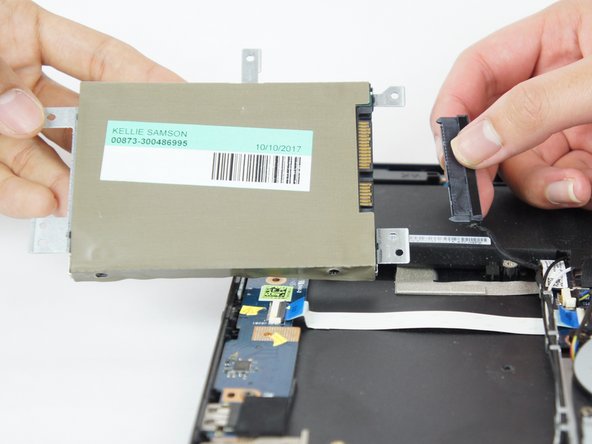

    • Lift the hard drive up and remove the power supply cable connected to it.
    • Make sure to pull on the plastic head and not the actual wires to prevent tearing them.

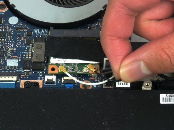

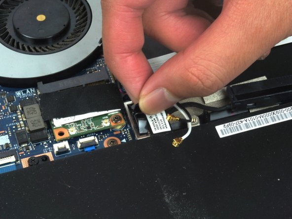

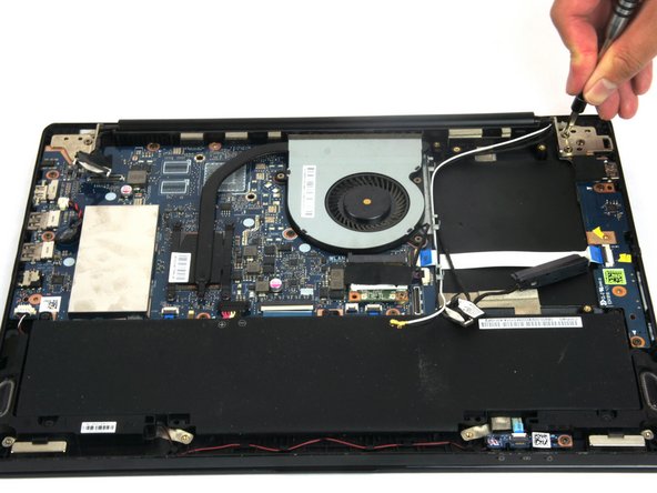

    • Disconnect the white and black wires attached to the Wi-Fi chip.
  6. Asus VivoBook Q302LA-BHI3T09 Display Replacement: crwdns2935265:06crwdnd2935265:01crwdnd2935265:03crwdne2935265:0 Asus VivoBook Q302LA-BHI3T09 Display Replacement: crwdns2935265:06crwdnd2935265:02crwdnd2935265:03crwdne2935265:0 Asus VivoBook Q302LA-BHI3T09 Display Replacement: crwdns2935265:06crwdnd2935265:03crwdnd2935265:03crwdne2935265:0

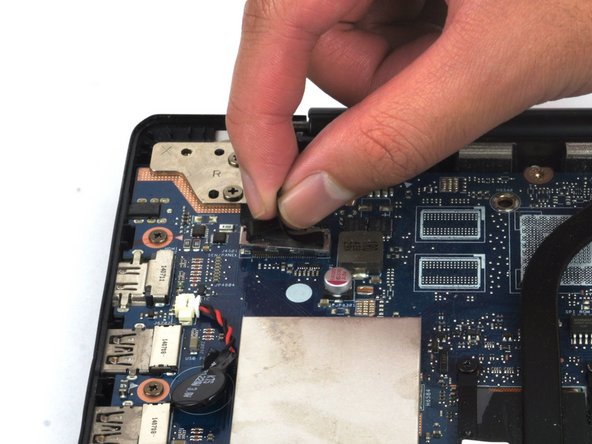

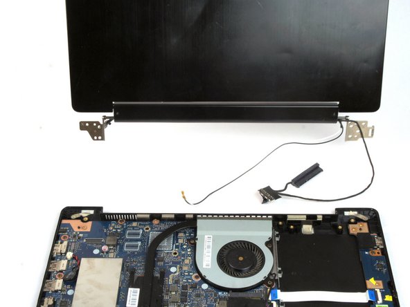

    • Remove the two adapters connecting the display to the motherboard by pulling the black plastic straps directly upwards.
  7. Asus VivoBook Q302LA-BHI3T09 Display Replacement: crwdns2935265:07crwdnd2935265:01crwdnd2935265:03crwdne2935265:0 Asus VivoBook Q302LA-BHI3T09 Display Replacement: crwdns2935265:07crwdnd2935265:02crwdnd2935265:03crwdne2935265:0 Asus VivoBook Q302LA-BHI3T09 Display Replacement: crwdns2935265:07crwdnd2935265:03crwdnd2935265:03crwdne2935265:0
    • Use the JIS #0 screwdriver to remove the five 5.0 mm screws connecting the display to the rest of the laptop.
