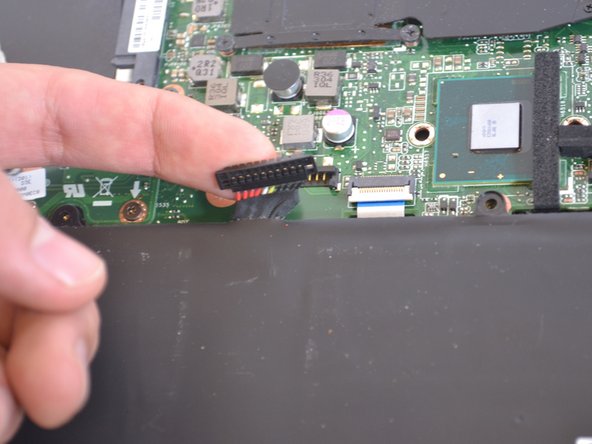

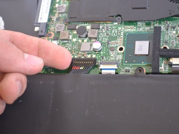

  5. Asus VivoBook Q200E-BSI3T08 Battery Replacement: crwdns2935265:05crwdnd2935265:01crwdnd2935265:03crwdne2935265:0 Asus VivoBook Q200E-BSI3T08 Battery Replacement: crwdns2935265:05crwdnd2935265:02crwdnd2935265:03crwdne2935265:0 Asus VivoBook Q200E-BSI3T08 Battery Replacement: crwdns2935265:05crwdnd2935265:03crwdnd2935265:03crwdne2935265:0
    • The battery is attached by a set of wires.
    • Use your finger to disconnect the set of wires. It should come off very easily.
