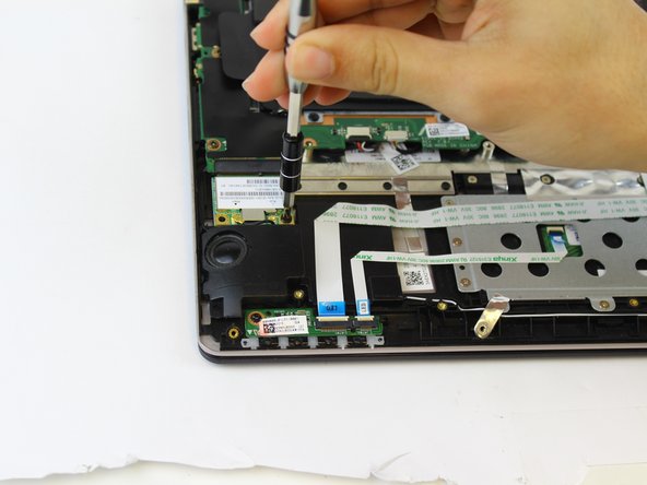

  6. Asus VivoBook Q200E-BHI3T45 WLAN (Wireless Chip) Replacement, WLAN (Wireless Chip): crwdns2935265:06crwdnd2935265:01crwdnd2935265:02crwdne2935265:0 Asus VivoBook Q200E-BHI3T45 WLAN (Wireless Chip) Replacement, WLAN (Wireless Chip): crwdns2935265:06crwdnd2935265:02crwdnd2935265:02crwdne2935265:0
    • Remove one 5mm screw using a PH0 Philips screwdriver.
  7. Asus VivoBook Q200E-BHI3T45 WLAN (Wireless Chip) Replacement: crwdns2935265:07crwdnd2935265:01crwdnd2935265:01crwdne2935265:0
    • Remove the cable by lifting upwards with a pair of tweezers.
  8. Asus VivoBook Q200E-BHI3T45 WLAN (Wireless Chip) Replacement: crwdns2935265:08crwdnd2935265:01crwdnd2935265:01crwdne2935265:0
    • Remove the WLAN chip by pulling out parallel to the surface.
