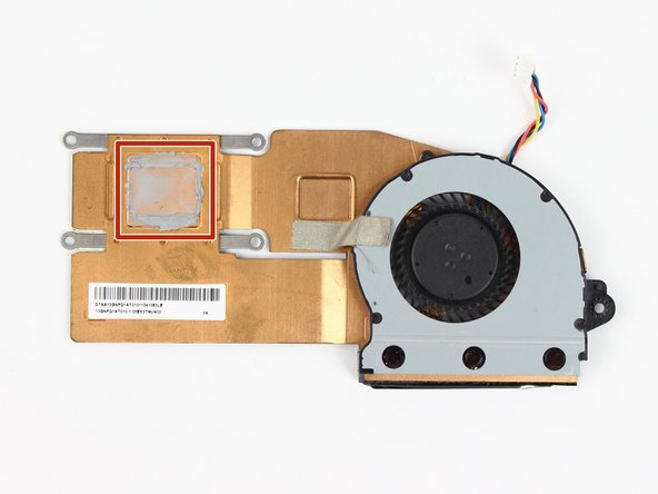

  10. Asus VivoBook Q200E-BHI3T45 Thermal Paste Replacement, Thermal Paste: crwdns2935265:010crwdnd2935265:01crwdnd2935265:02crwdne2935265:0 Asus VivoBook Q200E-BHI3T45 Thermal Paste Replacement, Thermal Paste: crwdns2935265:010crwdnd2935265:02crwdnd2935265:02crwdne2935265:0
    • Use isopropyl alcohol and a cotton ball to clean thermal paste off the CPU and back of the heatsink.
    • Apply a drop of thermal paste on the CPU.
    • Carefully place heatsink/fan assembly back.
