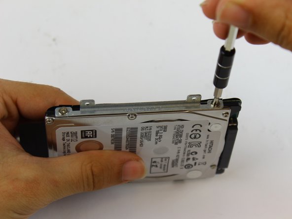

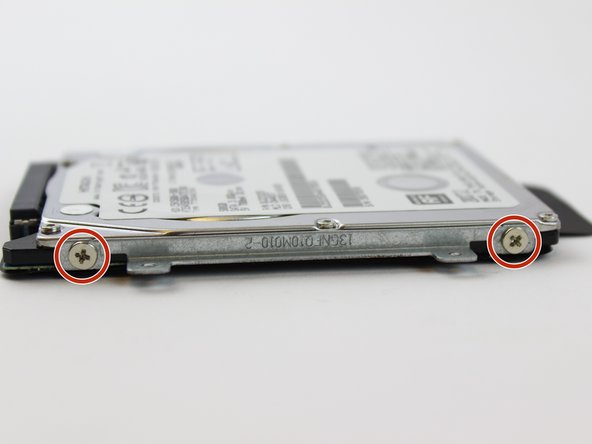

  8. Asus VivoBook Q200E-BHI3T45 Hard Drive Replacement: crwdns2935265:08crwdnd2935265:01crwdnd2935265:03crwdne2935265:0 Asus VivoBook Q200E-BHI3T45 Hard Drive Replacement: crwdns2935265:08crwdnd2935265:02crwdnd2935265:03crwdne2935265:0 Asus VivoBook Q200E-BHI3T45 Hard Drive Replacement: crwdns2935265:08crwdnd2935265:03crwdnd2935265:03crwdne2935265:0
    • Remove two 3mm screws using a Phillips 0 screwdriver from each sides of the hard drive bracket. The bracket should fall off after removal.
