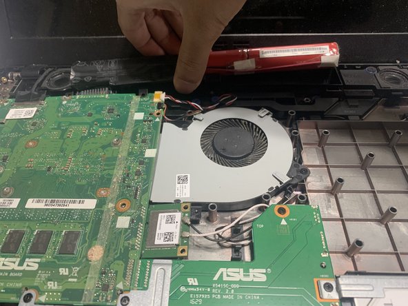

    • Remove the two 1.2 mm screws holding the battery in place using the Phillips #00 screwdriver.
  6. Asus VivoBook Max X541UV-BH71-CB Battery Replacement: crwdns2935265:06crwdnd2935265:01crwdnd2935265:03crwdne2935265:0 Asus VivoBook Max X541UV-BH71-CB Battery Replacement: crwdns2935265:06crwdnd2935265:02crwdnd2935265:03crwdne2935265:0 Asus VivoBook Max X541UV-BH71-CB Battery Replacement: crwdns2935265:06crwdnd2935265:03crwdnd2935265:03crwdne2935265:0
    • Carefully remove the battery using a plastic opening tool.
