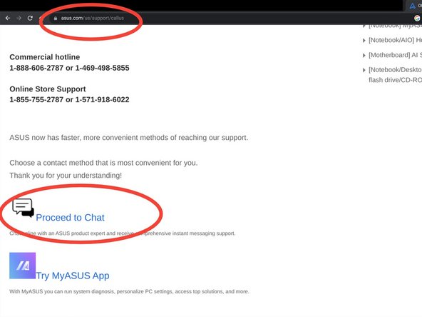

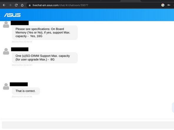

    • The model name, submodel, and serial number are all on the back label of your laptop.
    • If you're having trouble finding the technical specifications for your model, contact Asus through their customer support webpage. Without knowing the specs, you won't know how much RAM to buy or if there's a SODIMM slot at all.
    • If you request an online chat, they'll take down your serial number, and let you know exactly what kind of RAM upgrade you can do for your model.
    • Ask questions if anything they tell you is unclear.
