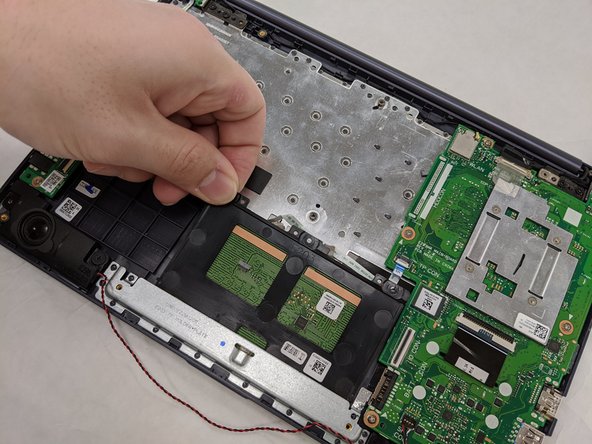

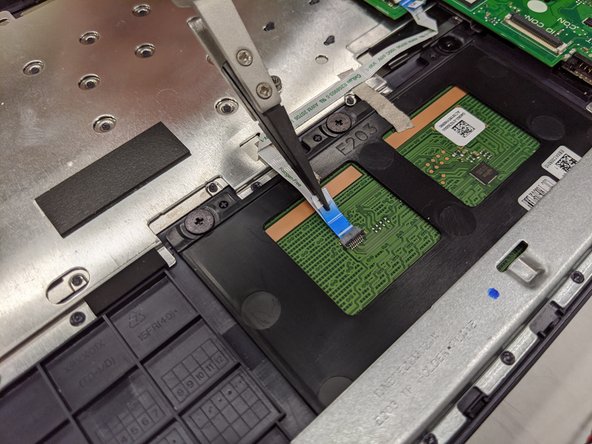

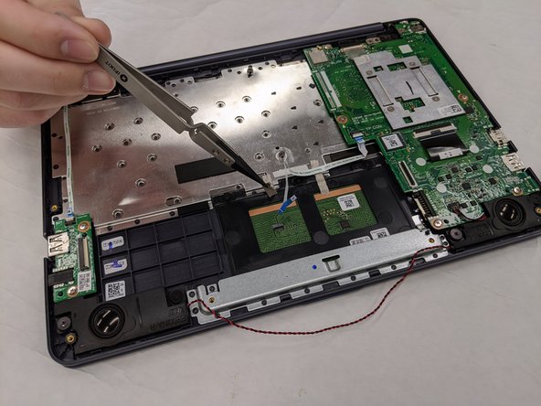

  8. Asus VivoBook E203MA-TBCL432B TrackPad Replacement, TrackPad: crwdns2935265:08crwdnd2935265:01crwdnd2935265:03crwdne2935265:0 Asus VivoBook E203MA-TBCL432B TrackPad Replacement, TrackPad: crwdns2935265:08crwdnd2935265:02crwdnd2935265:03crwdne2935265:0 Asus VivoBook E203MA-TBCL432B TrackPad Replacement, TrackPad: crwdns2935265:08crwdnd2935265:03crwdnd2935265:03crwdne2935265:0
    • Insert the iFixit tool underneath the cable that is attached to the trackpad to unclip the cable.
    • Using the reverse tweezers, remove the ribbon cable and the tape that is attached to the trackpad.
  9. Asus VivoBook E203MA-TBCL432B TrackPad Replacement: crwdns2935265:09crwdnd2935265:01crwdnd2935265:01crwdne2935265:0
    • Using a Phillips #00 screwdriver, remove the three 2.0 mm screws above the trackpad.

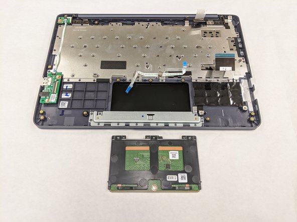

  10. Asus VivoBook E203MA-TBCL432B TrackPad Replacement: crwdns2935265:010crwdnd2935265:01crwdnd2935265:03crwdne2935265:0 Asus VivoBook E203MA-TBCL432B TrackPad Replacement: crwdns2935265:010crwdnd2935265:02crwdnd2935265:03crwdne2935265:0 Asus VivoBook E203MA-TBCL432B TrackPad Replacement: crwdns2935265:010crwdnd2935265:03crwdnd2935265:03crwdne2935265:0
    • Insert the iFixit opening tool under the frame that surrounds the trackpad and carefully pry the frame of the trackpad up.
    • Now that the track pad is lifted up, gently slide it out by pulling it towards the hinges.
