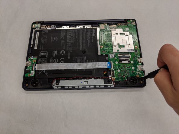

    • Position the laptop so that the bottom panel is facing upwards, the hinge is away from you, and the ASUS logo is against the table.
    • It will be easier to replace the battery if the laptop is closed.
  2. Asus VivoBook E203MA-TBCL432B Speaker Replacement: crwdns2935265:02crwdnd2935265:01crwdnd2935265:03crwdne2935265:0 Asus VivoBook E203MA-TBCL432B Speaker Replacement: crwdns2935265:02crwdnd2935265:02crwdnd2935265:03crwdne2935265:0 Asus VivoBook E203MA-TBCL432B Speaker Replacement: crwdns2935265:02crwdnd2935265:03crwdnd2935265:03crwdne2935265:0
    • Use a Phillips #0 screwdriver to remove the eight 5 mm screws on the back panel.
    • Remove the two 7 mm Phillips #0 screws.
    • The 8 screws marked in red are all of the same length, 5 mm, and should not be interchanged with the two longer 7 mm screws marked in orange.

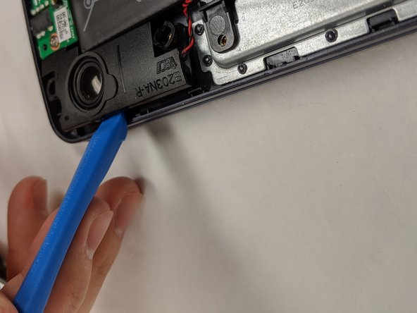

  3. Asus VivoBook E203MA-TBCL432B Speaker Replacement: crwdns2935265:03crwdnd2935265:01crwdnd2935265:03crwdne2935265:0 Asus VivoBook E203MA-TBCL432B Speaker Replacement: crwdns2935265:03crwdnd2935265:02crwdnd2935265:03crwdne2935265:0 Asus VivoBook E203MA-TBCL432B Speaker Replacement: crwdns2935265:03crwdnd2935265:03crwdnd2935265:03crwdne2935265:0
    • Insert the iFixit opening tool in between the back panel and the rest of the laptop.
    • With the iFixit opening tool, lift the panel from the laptop body. Work your way around the device creating separation with the tool.
    • Once there is enough separation between the back panel and the device, gently pull off the back panel with your hands and completely remove it.
    • Make sure to use a plastic tool, not a metal one, so that you don't scratch the panel.

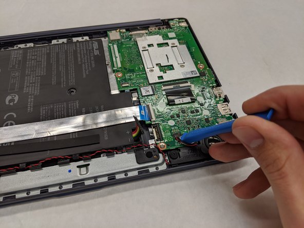

  4. Asus VivoBook E203MA-TBCL432B Speaker Replacement, Speaker: crwdns2935265:04crwdnd2935265:01crwdnd2935265:03crwdne2935265:0 Asus VivoBook E203MA-TBCL432B Speaker Replacement, Speaker: crwdns2935265:04crwdnd2935265:02crwdnd2935265:03crwdne2935265:0 Asus VivoBook E203MA-TBCL432B Speaker Replacement, Speaker: crwdns2935265:04crwdnd2935265:03crwdnd2935265:03crwdne2935265:0
    • Using the iFixit opening tool, pry up and remove the battery connector from the motherboard.
    • Using the iFixit opening tool again, carefully wedge the tool under a corner of the speaker connector on the motherboard that is connected by three wires (colored red, black, and white).
    • Slowly pry the connector up without damaging the motherboard.

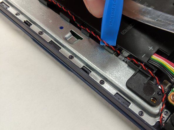

  5. Asus VivoBook E203MA-TBCL432B Speaker Replacement: crwdns2935265:05crwdnd2935265:01crwdnd2935265:03crwdne2935265:0 Asus VivoBook E203MA-TBCL432B Speaker Replacement: crwdns2935265:05crwdnd2935265:02crwdnd2935265:03crwdne2935265:0 Asus VivoBook E203MA-TBCL432B Speaker Replacement: crwdns2935265:05crwdnd2935265:03crwdnd2935265:03crwdne2935265:0
    • Using a Phillips #00 screwdriver, remove the four 2.0 mm screws near the edge opposite of the hinge.
    • Insert the iFixit opening tool underneath the red and black wire and remove the wire from the small clasps.

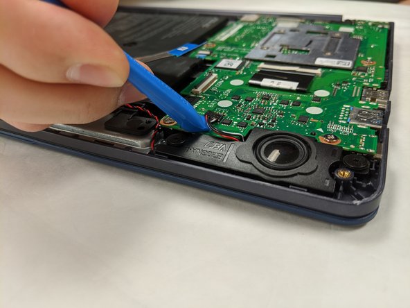

  6. Asus VivoBook E203MA-TBCL432B Speaker Replacement: crwdns2935265:06crwdnd2935265:01crwdnd2935265:02crwdne2935265:0 Asus VivoBook E203MA-TBCL432B Speaker Replacement: crwdns2935265:06crwdnd2935265:02crwdnd2935265:02crwdne2935265:0
    • Insert the iFixit opening tool underneath the speaker on the right side. Gently pry the speaker up to remove.
    • Repeat the step above for the opposite speaker. Then, carefully set both speakers off to the side.
