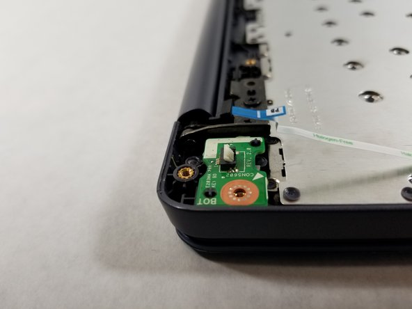

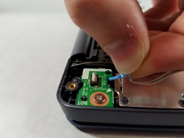

  4. Asus VivoBook E203MA-TBCL432B Power Button Replacement, Power Button: crwdns2935265:04crwdnd2935265:01crwdnd2935265:02crwdne2935265:0 Asus VivoBook E203MA-TBCL432B Power Button Replacement, Power Button: crwdns2935265:04crwdnd2935265:02crwdnd2935265:02crwdne2935265:0
    • Remove the single connector by first pulling back the white tab and then pulling the connector out with the blue tab.
  5. Asus VivoBook E203MA-TBCL432B Power Button Replacement: crwdns2935265:05crwdnd2935265:01crwdnd2935265:02crwdne2935265:0 Asus VivoBook E203MA-TBCL432B Power Button Replacement: crwdns2935265:05crwdnd2935265:02crwdnd2935265:02crwdne2935265:0
    • Remove the single 2 mm screw with a Phillips #0 screwdriver.
  6. Asus VivoBook E203MA-TBCL432B Power Button Replacement: crwdns2935265:06crwdnd2935265:01crwdnd2935265:01crwdne2935265:0
    • Now that the power button component is free, lift it up and out of the laptop.
