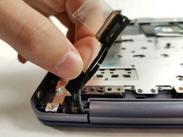

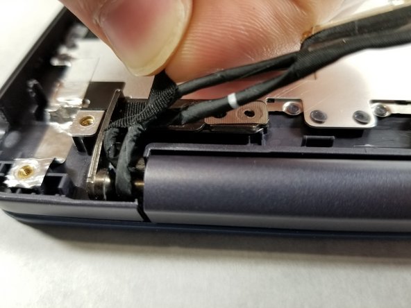

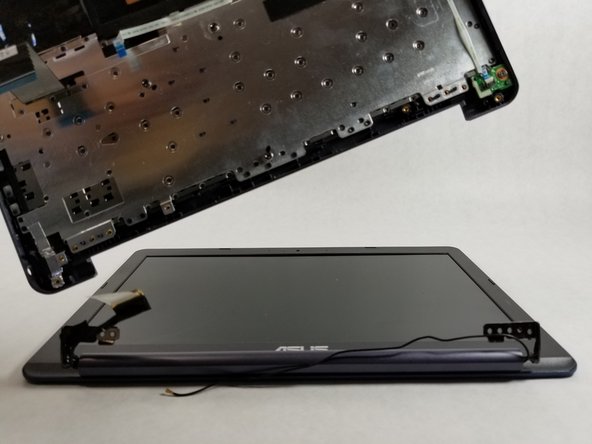

  14. Asus VivoBook E203MA-TBCL432B Display Assembly Replacement, Display Assembly: crwdns2935265:014crwdnd2935265:01crwdnd2935265:03crwdne2935265:0 Asus VivoBook E203MA-TBCL432B Display Assembly Replacement, Display Assembly: crwdns2935265:014crwdnd2935265:02crwdnd2935265:03crwdne2935265:0 Asus VivoBook E203MA-TBCL432B Display Assembly Replacement, Display Assembly: crwdns2935265:014crwdnd2935265:03crwdnd2935265:03crwdne2935265:0
    • Position the device so that the hinge is closest to you.
    • Identify the connector with two thick wires that previously attached the LCD to the motherboard.
    • Gently remove the tape on the wires that binds the connector to the metal hinge.

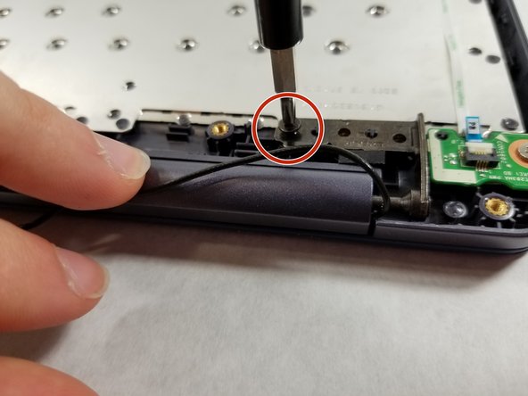

  15. Asus VivoBook E203MA-TBCL432B Display Assembly Replacement: crwdns2935265:015crwdnd2935265:01crwdnd2935265:02crwdne2935265:0 Asus VivoBook E203MA-TBCL432B Display Assembly Replacement: crwdns2935265:015crwdnd2935265:02crwdnd2935265:02crwdne2935265:0

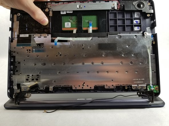

    • There are two hinges at the bottom of the laptop: one on the left side, and one on the right side.
    • Using a Phillips #0 screwdriver, remove the three 3 mm screws that are through the hinges.

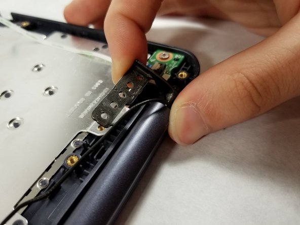

  16. Asus VivoBook E203MA-TBCL432B Display Assembly Replacement: crwdns2935265:016crwdnd2935265:01crwdnd2935265:03crwdne2935265:0 Asus VivoBook E203MA-TBCL432B Display Assembly Replacement: crwdns2935265:016crwdnd2935265:02crwdnd2935265:03crwdne2935265:0 Asus VivoBook E203MA-TBCL432B Display Assembly Replacement: crwdns2935265:016crwdnd2935265:03crwdnd2935265:03crwdne2935265:0

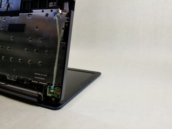

    • Lift each of the hinge tabs up from the device approximately 90 degrees.

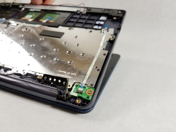

  17. Asus VivoBook E203MA-TBCL432B Display Assembly Replacement: crwdns2935265:017crwdnd2935265:01crwdnd2935265:03crwdne2935265:0 Asus VivoBook E203MA-TBCL432B Display Assembly Replacement: crwdns2935265:017crwdnd2935265:02crwdnd2935265:03crwdne2935265:0 Asus VivoBook E203MA-TBCL432B Display Assembly Replacement: crwdns2935265:017crwdnd2935265:03crwdnd2935265:03crwdne2935265:0
    • With the hinge facing towards you, open your device approximately 90 degrees.
    • This should make it easier to separate the two components.

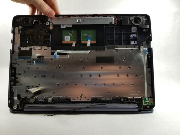

  18. Asus VivoBook E203MA-TBCL432B Display Assembly Replacement: crwdns2935265:018crwdnd2935265:01crwdnd2935265:03crwdne2935265:0 Asus VivoBook E203MA-TBCL432B Display Assembly Replacement: crwdns2935265:018crwdnd2935265:02crwdnd2935265:03crwdne2935265:0 Asus VivoBook E203MA-TBCL432B Display Assembly Replacement: crwdns2935265:018crwdnd2935265:03crwdnd2935265:03crwdne2935265:0
    • Push the bottom portion of your device away from you to separate it from the LCD
    • The two components should separate with a little force.
To reassemble your device, follow these instructions in reverse order. Be mindful of the wire that connects the screen to the motherboard. If it is not properly tucked into the body of the laptop, the hinge may not close properly.
