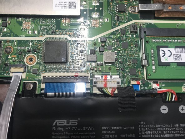

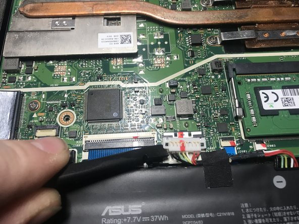

  3. Asus VivoBook 14" F412DA Battery Replacement, Release battery connector: crwdns2935265:03crwdnd2935265:01crwdnd2935265:03crwdne2935265:0 Asus VivoBook 14" F412DA Battery Replacement, Release battery connector: crwdns2935265:03crwdnd2935265:02crwdnd2935265:03crwdne2935265:0 Asus VivoBook 14" F412DA Battery Replacement, Release battery connector: crwdns2935265:03crwdnd2935265:03crwdnd2935265:03crwdne2935265:0
    • Using a fingernail or spudger move back the retaining clip holding the battery connector in place.
    • Be gentle releasing the connector, it's very fragile.
  4. Asus VivoBook 14" F412DA Battery Replacement, Disconnect the battery: crwdns2935265:04crwdnd2935265:01crwdnd2935265:03crwdne2935265:0 Asus VivoBook 14" F412DA Battery Replacement, Disconnect the battery: crwdns2935265:04crwdnd2935265:02crwdnd2935265:03crwdne2935265:0 Asus VivoBook 14" F412DA Battery Replacement, Disconnect the battery: crwdns2935265:04crwdnd2935265:03crwdnd2935265:03crwdne2935265:0
    • Put a spudger under the battery connector and twist, the connector should lift off.
    • Caution: Use a plastic tool, to avoid risk of puncturing the battery. A punctured battery may leak dangerous chemicals or catch fire.
