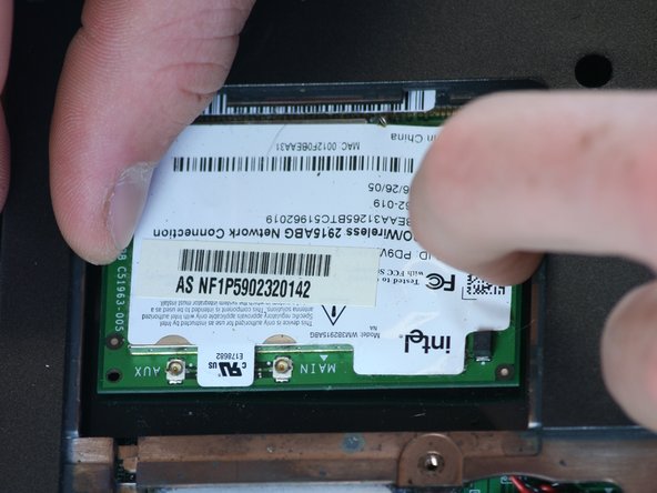

    • Locate the tabs that are holding the wireless card in place. These are highlighted in picture.
    • Place one finger on each tab and press each to the side away from the wireless card as shown.

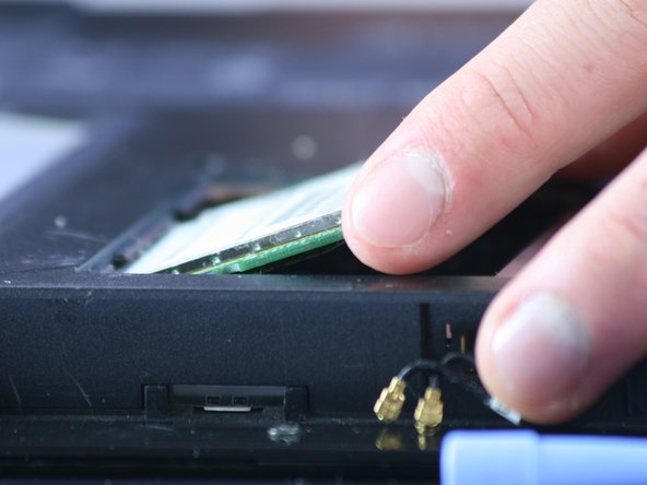

    • The wireless card should pop up as shown. Pull up more with fingers to get more clearance.

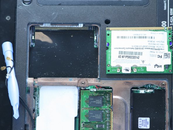

    • To remove the wireless card, pull the card directly out.
    • It should come out with just a little bit of pressure.
    • It should look as shown when removed.
