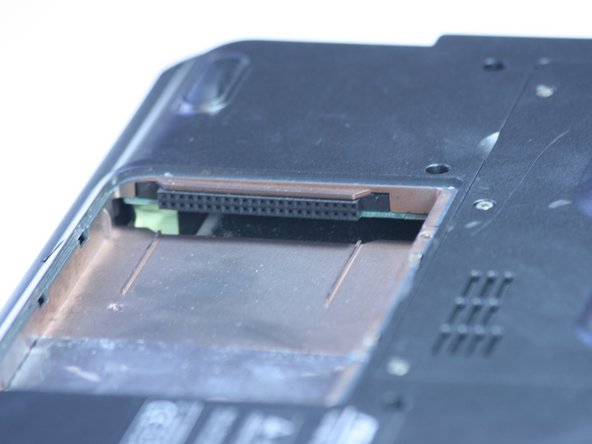

  3. Asus V6800V Hard Drive Replacement: crwdns2935265:03crwdnd2935265:01crwdnd2935265:02crwdne2935265:0 Asus V6800V Hard Drive Replacement: crwdns2935265:03crwdnd2935265:02crwdnd2935265:02crwdne2935265:0
    • The highlighted area is where your hard drive would be. Slide it out away from its slot and pull it gently to remove.
    • Second image shows what it should look like once you remove the hard drive.
