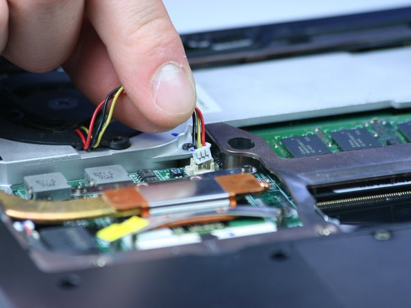

    • Unplug the wires by pulling straight up on the white connector and away from the computer.
    • Make sure not to pull on the wires (as shown in the second picture). The white connector should pop off with very little force.

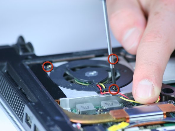

    • Use a Phillips #0 to remove the three screws holding the fan in place.

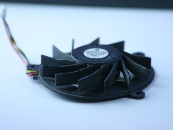

    • Remove the fan from the device.
    • The fan should remove easily.

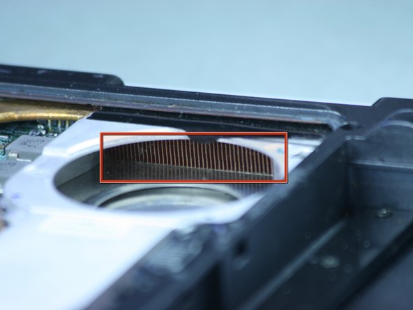

    • Use a cotton swab or compressed air to blow air from the inside, out to clear dust from the vent or heat sink.
