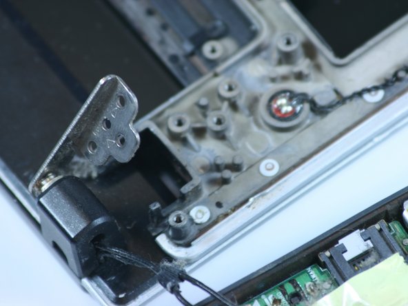

  12. Asus V6800V Display Replacement: crwdns2935265:012crwdnd2935265:01crwdnd2935265:01crwdne2935265:0

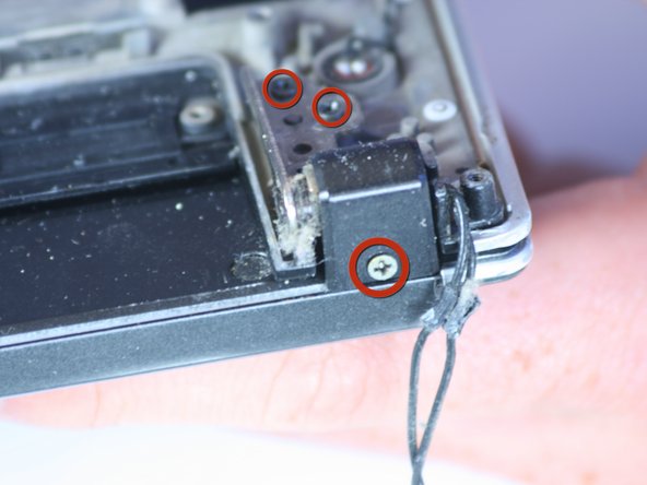

    • Remove the small enclosures around the hinges.
  13. Asus V6800V Display Replacement: crwdns2935265:013crwdnd2935265:01crwdnd2935265:02crwdne2935265:0 Asus V6800V Display Replacement: crwdns2935265:013crwdnd2935265:02crwdnd2935265:02crwdne2935265:0

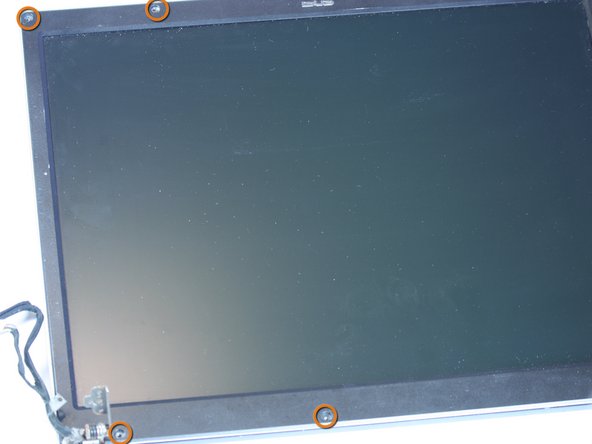

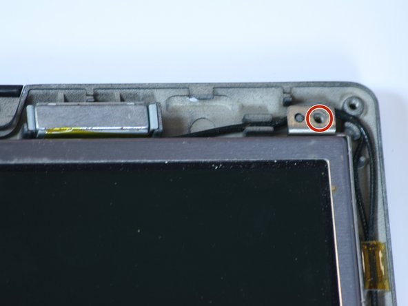

  15. Asus V6800V Display Replacement: crwdns2935265:015crwdnd2935265:01crwdnd2935265:02crwdne2935265:0 Asus V6800V Display Replacement: crwdns2935265:015crwdnd2935265:02crwdnd2935265:02crwdne2935265:0
    • Remove six screws from underneath the bezel with a Phillips #0 screwdriver. Two are located next to each hinge and one at each top corner.
    • Beware of the magnets at the top of the display. If they are moved out of position as you remove the display, gently place them back in their original position.

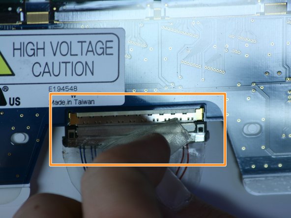

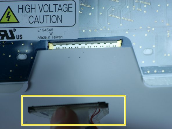

  17. Asus V6800V Display Replacement: crwdns2935265:017crwdnd2935265:01crwdnd2935265:03crwdne2935265:0 Asus V6800V Display Replacement: crwdns2935265:017crwdnd2935265:02crwdnd2935265:03crwdne2935265:0 Asus V6800V Display Replacement: crwdns2935265:017crwdnd2935265:03crwdnd2935265:03crwdne2935265:0
    • Look behind the display. Locate the display connector.
    • Peel back the tape from over the connector.
    • Remove the connector from the display and slowly pull the cable away, peeling the tape back along the way.

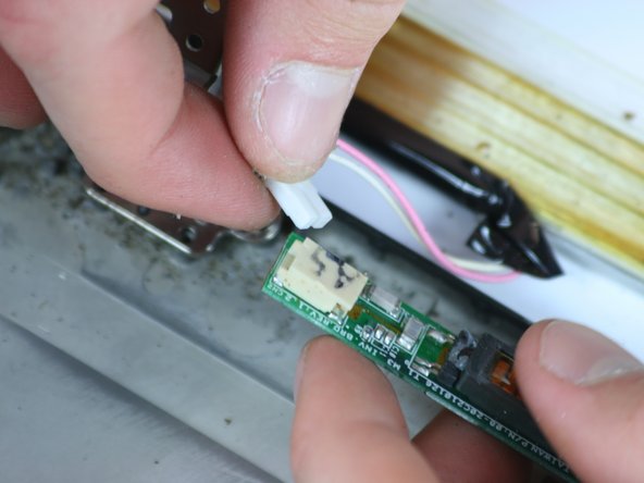

  19. Asus V6800V Display Replacement: crwdns2935265:019crwdnd2935265:01crwdnd2935265:02crwdne2935265:0 Asus V6800V Display Replacement: crwdns2935265:019crwdnd2935265:02crwdnd2935265:02crwdne2935265:0
    • Remove the small connector located near the right hinge.
    • Be aware of the direction the cables are removed. They need to be replaced exactly the same later.
