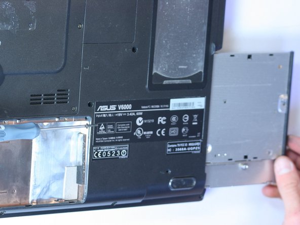

  5. Asus V6800V CD/DVD Drive Replacement, CD/DVD Drive: crwdns2935265:05crwdnd2935265:01crwdnd2935265:02crwdne2935265:0 Asus V6800V CD/DVD Drive Replacement, CD/DVD Drive: crwdns2935265:05crwdnd2935265:02crwdnd2935265:02crwdne2935265:0
    • Remove the screw from the bottom right corner using a Phillips #0 screwdriver.
    • Insert a spudger into the hole to carefully push the CD/DVD drive out.
To reassemble your device, just push the new CD/DVD driver back. Then put the components back together then put the screws back in.
