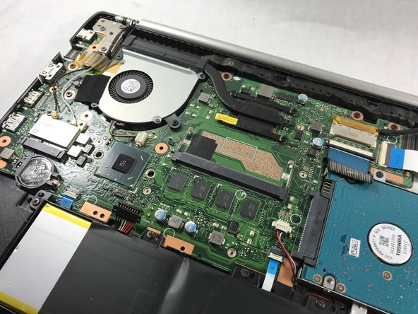

  5. Asus V500CA-DB51T WiFi Card Replacement: crwdns2935265:05crwdnd2935265:01crwdnd2935265:03crwdne2935265:0 Asus V500CA-DB51T WiFi Card Replacement: crwdns2935265:05crwdnd2935265:02crwdnd2935265:03crwdne2935265:0 Asus V500CA-DB51T WiFi Card Replacement: crwdns2935265:05crwdnd2935265:03crwdnd2935265:03crwdne2935265:0
    • Use the opening tool to pop up the battery away from the casing.

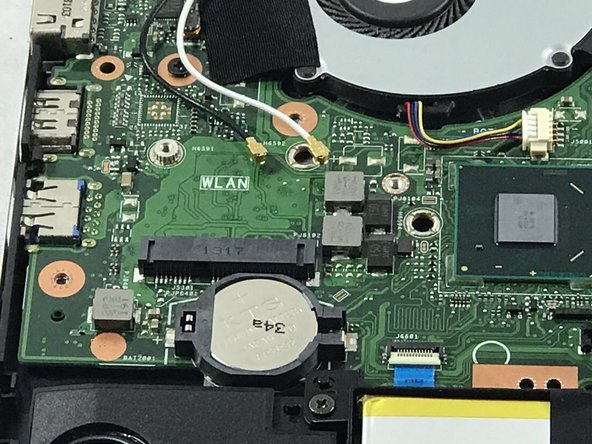

  6. Asus V500CA-DB51T WiFi Card Replacement, WiFi Card: crwdns2935265:06crwdnd2935265:01crwdnd2935265:02crwdne2935265:0 Asus V500CA-DB51T WiFi Card Replacement, WiFi Card: crwdns2935265:06crwdnd2935265:02crwdnd2935265:02crwdne2935265:0
    • Locate the section of the device that houses the WiFi Card.
    • This should be a white, square-shaped object located just above the left end of the battery.
  7. Asus V500CA-DB51T WiFi Card Replacement: crwdns2935265:07crwdnd2935265:01crwdnd2935265:02crwdne2935265:0 Asus V500CA-DB51T WiFi Card Replacement: crwdns2935265:07crwdnd2935265:02crwdnd2935265:02crwdne2935265:0
    • Disconnect the black and white wires that are connected to the WiFi card by gently pulling them upward with a pair of tweezers.
    • Using the tweezers, gently pull the WiFi card out away from yourself.
    • If you try pulling up you could cause damage, so be sure to slowly and gently pull the card away from yourself.
