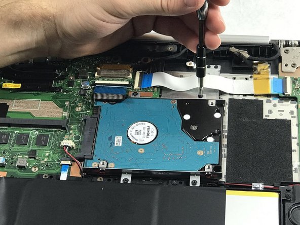

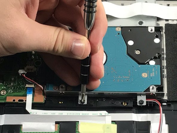

    • Remove the following screws securing the battery connector board to the logic board:
    • The red screws are size 2.3 cm T6 Torx
    • The orange screws are size 2.4 cm T6 Torx
  7. Asus V500CA-DB51T Speaker Replacement: crwdns2935265:07crwdnd2935265:01crwdnd2935265:02crwdne2935265:0 Asus V500CA-DB51T Speaker Replacement: crwdns2935265:07crwdnd2935265:02crwdnd2935265:02crwdne2935265:0
    • Remove the SSD (Solid State Drive) assembly from the upper case.

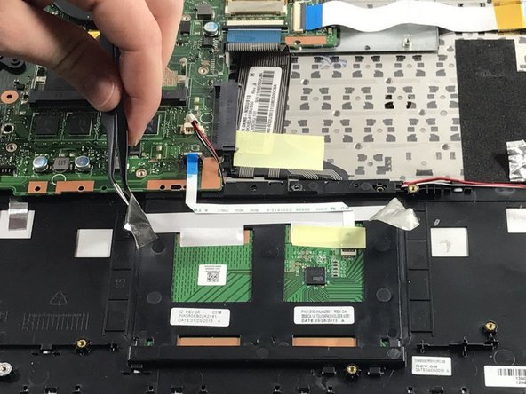

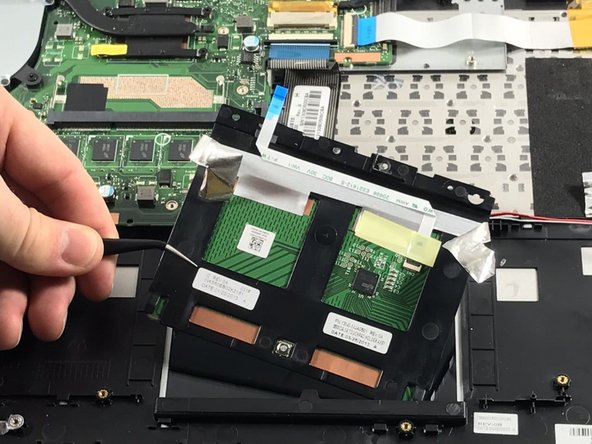

    • Using the tweezers gently remove the ribbon cable.
    • Also using the tweezers pry off the metallic tape on both sides of the mouse pad.
    • Remove the mouse pad from the main assembly.

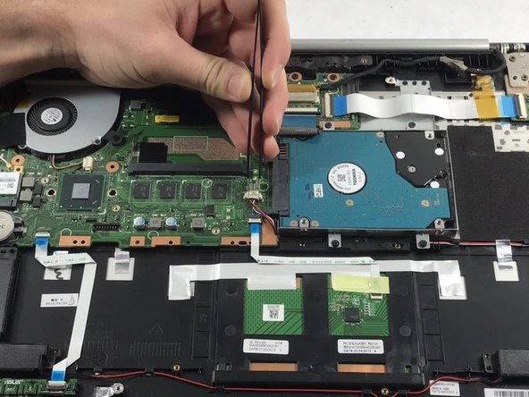

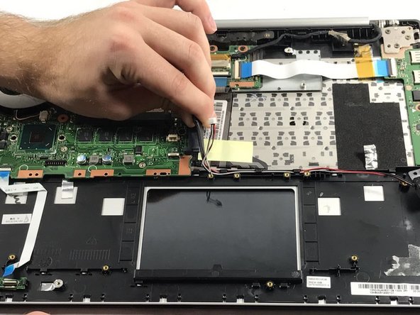

    • Remove the ribbon cable for the LED lights.
    • Remove the speaker wire cable from the main board.
    • Slowly pull the speaker wire from the assembly.
