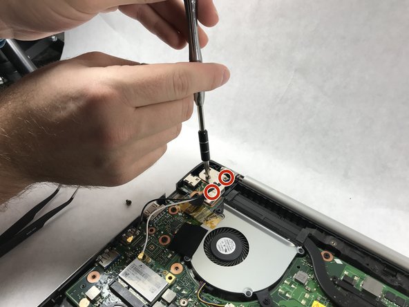

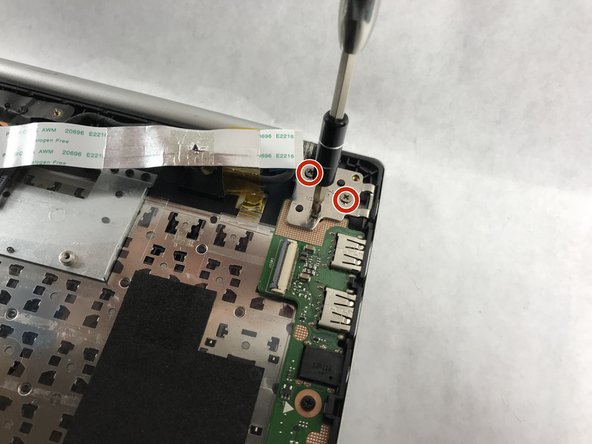

  8. Asus V500CA-DB51T Screen Replacement, Screen: crwdns2935265:08crwdnd2935265:01crwdnd2935265:03crwdne2935265:0 Asus V500CA-DB51T Screen Replacement, Screen: crwdns2935265:08crwdnd2935265:02crwdnd2935265:03crwdne2935265:0 Asus V500CA-DB51T Screen Replacement, Screen: crwdns2935265:08crwdnd2935265:03crwdnd2935265:03crwdne2935265:0
    • Gently remove the ribbon cable using tweezers.
    • Using the Phillips #00 screwdriver remove the six .4 cm screws from the screen brackets.

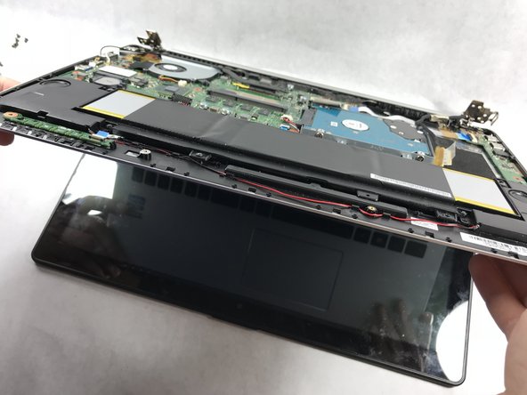

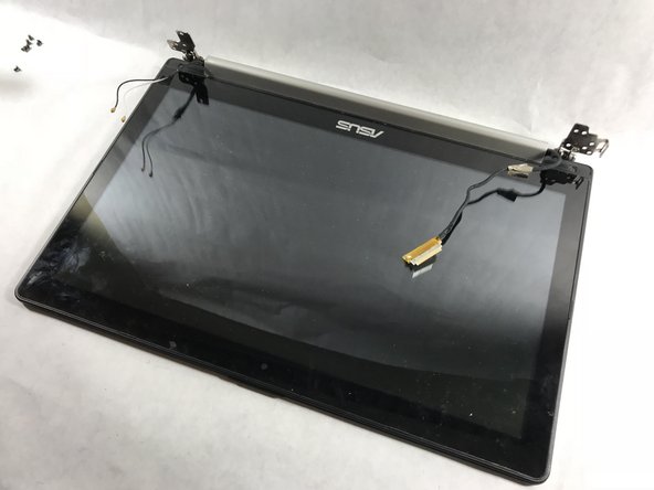

  9. Asus V500CA-DB51T Screen Replacement: crwdns2935265:09crwdnd2935265:01crwdnd2935265:03crwdne2935265:0 Asus V500CA-DB51T Screen Replacement: crwdns2935265:09crwdnd2935265:02crwdnd2935265:03crwdne2935265:0 Asus V500CA-DB51T Screen Replacement: crwdns2935265:09crwdnd2935265:03crwdnd2935265:03crwdne2935265:0
    • Slowly lift up on the main case of the laptop.
    • Gently pull the laptop from the screen when it is perpendicular with the screen.
