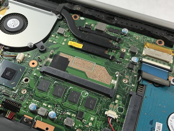

  6. Asus V500CA-DB51T RAM Replacement, RAM: crwdns2935265:06crwdnd2935265:01crwdnd2935265:02crwdne2935265:0 Asus V500CA-DB51T RAM Replacement, RAM: crwdns2935265:06crwdnd2935265:02crwdnd2935265:02crwdne2935265:0
    • Pull the two RAM retaining arms away from the center of the RAM chip.
    • The RAM will pop up by a few millimeters.
    • Pull the RAM stick out of its socket.

"Step 6: Using a pair of tweezers, gently pull the RAM out of its socket." Uhhhh, NO!!!! This is horrible advice. Most tweezers are made of metal, rigid and have hard angles. #1, never touch anything metal to ANYTHING inside of a computer. You could send an electrostatic surge from your body through the tweezers to the object you're going to touch. THIS IS A GINORMOUS NO-NO!. Unless the tweezers are made of plastic or wood, you should never consider this, EVER!
The correct way to do this is to ground yourself with a grounding strap. If you don't have one of those, touch a piece of metal that may be grounded. If you don't have that, touch a computer case with both hands to drain your static charge, since computers are grounded. Then, WITH YOUR >>>HANDS ONLY<<<, remove the stick of memory.
I've been building computers for 20+ years. NEVER HAVE I EVER heard someone say use tweezers to touch any internal components. That's just a recipe for nuking your computer. DONT DO IT!
Jeff Oculush - crwdns2934203:0crwdne2934203:0
Hi @jeffoculush, thank you for pointing that out! We've made an update to the guide to reflect proper instructions and also deleted the photo. Thanks again!
