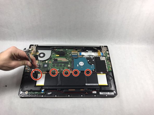

  3. Asus V500CA-DB51T Battery  Replacement: crwdns2935265:03crwdnd2935265:01crwdnd2935265:01crwdne2935265:0
    • Use the flat end of the blue plastic opening tool to lift the battery connector up out of its socket on the motherboard.
  4. Asus V500CA-DB51T Battery  Replacement: crwdns2935265:04crwdnd2935265:01crwdnd2935265:02crwdne2935265:0 Asus V500CA-DB51T Battery  Replacement: crwdns2935265:04crwdnd2935265:02crwdnd2935265:02crwdne2935265:0
    • Remove the tri-point screws that secure the battery to the casing.
    • All screws securing the battery in place are .5 cm tri-point screws.
  5. Asus V500CA-DB51T Battery  Replacement: crwdns2935265:05crwdnd2935265:01crwdnd2935265:03crwdne2935265:0 Asus V500CA-DB51T Battery  Replacement: crwdns2935265:05crwdnd2935265:02crwdnd2935265:03crwdne2935265:0 Asus V500CA-DB51T Battery  Replacement: crwdns2935265:05crwdnd2935265:03crwdnd2935265:03crwdne2935265:0
    • Use the opening tool to pop up the battery away from the casing.
