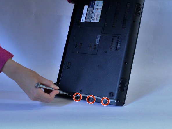

  8. Asus UL80J Wifi Card Replacement: crwdns2935265:09crwdnd2935265:01crwdnd2935265:01crwdne2935265:0
    • Unscrew these nine 6 mm screws on the back cover, as these hold down the plastic cover on top.

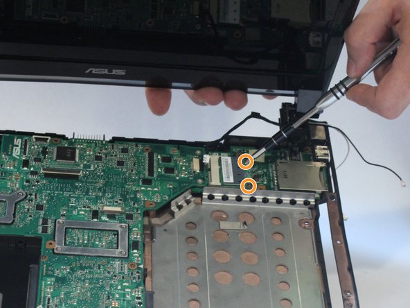

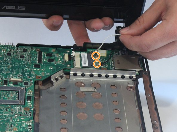

    • Before removing the plastic cover, there will be two ribbon cables that require detachment with locations indicated by the red arrows. Carefully lift up the cover to expose the motherboard and components.
    • The WiFi card is located in the upper right corner. Disconnect the black and white wires. It is attached via two 3 mm screws. Remove these screws to remove the WiFi card.
