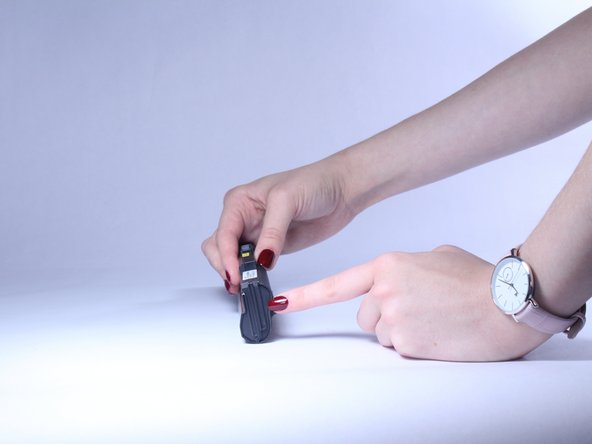

    • Place laptop face down with battery facing up.
  2. Asus UL80J Screen Replacement: crwdns2935265:02crwdnd2935265:01crwdnd2935265:01crwdne2935265:0
    • Slide unlock button to the right.

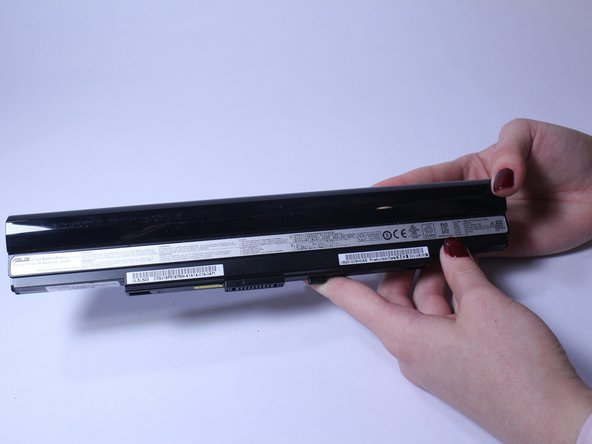

  3. Asus UL80J Screen Replacement: crwdns2935265:03crwdnd2935265:01crwdnd2935265:03crwdne2935265:0 Asus UL80J Screen Replacement: crwdns2935265:03crwdnd2935265:02crwdnd2935265:03crwdne2935265:0 Asus UL80J Screen Replacement: crwdns2935265:03crwdnd2935265:03crwdnd2935265:03crwdne2935265:0
    • Slide the button marked with an arrow to the left. The battery should now unclick. Slide the battery away from the laptop to remove it.

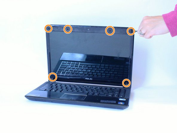

  4. Asus UL80J Screen Replacement, Screen: crwdns2935265:04crwdnd2935265:01crwdnd2935265:03crwdne2935265:0 Asus UL80J Screen Replacement, Screen: crwdns2935265:04crwdnd2935265:02crwdnd2935265:03crwdne2935265:0 Asus UL80J Screen Replacement, Screen: crwdns2935265:04crwdnd2935265:03crwdnd2935265:03crwdne2935265:0
    • Flip laptop back over and open it so that the screen faces you. Several rubber cushions hide screws around the bezel (surrounding frame). Remove these first to get to the screws underneath. The two bottom covers are stickers. Then remove all screws holding the bezel in place.
    • There will be four 3 mm screws located on the top and two 5 mm screws located on the bottom of the bezel.

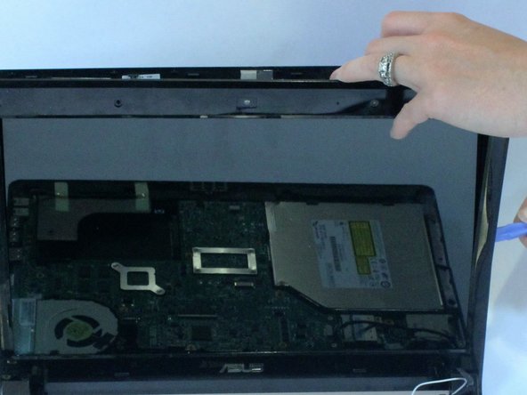

  5. Asus UL80J Screen Replacement: crwdns2935265:05crwdnd2935265:01crwdnd2935265:02crwdne2935265:0 Asus UL80J Screen Replacement: crwdns2935265:05crwdnd2935265:02crwdnd2935265:02crwdne2935265:0
    • Next, completely remove the bezel using a plastic opening tool to work your way around while gently prying it from the LCD. If it does not come off with a moderate amount of force check that you did not miss any screws.
