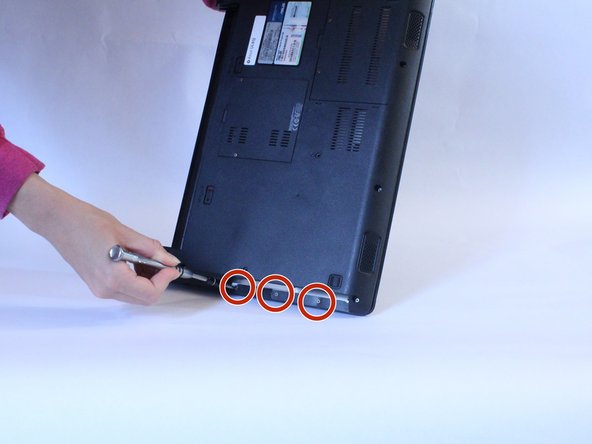

    • Once the keyboard is removed, take out the nine 6 mm screws on the back side of the laptop.

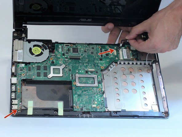

    • After you remove the front cover, the motherboard should be exposed, along with the two port boards.
    • Remove the seven, 3 mm screws holding the motherboard and ports into the frame of the laptop, as well as the two wire bundles indicated by red arrows.
    • You can now lift the motherboard out of the frame while simultaneously disconnecting the wires on the underside.

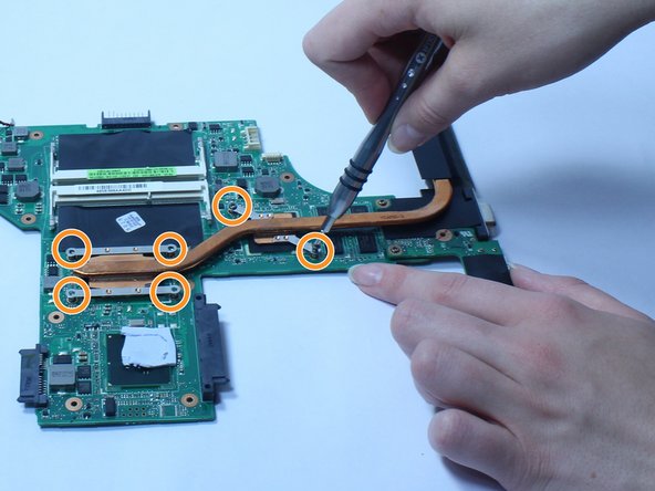

    • Remove the four, 3 mm screws and disconnect the red and black wire from to the motherboard.
    • Unscrew the six, 5 mm screws to disconnect the copper heat pipe.

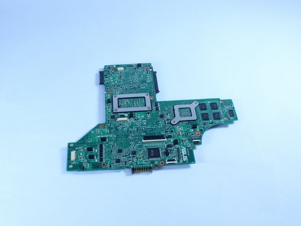

    • Once these are removed, the motherboard can be replaced.
