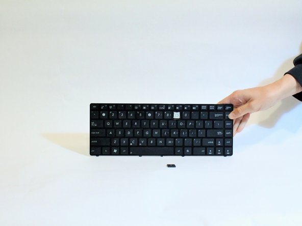

    • Keep unclipping the keyboard along the perimeter. Once the keyboard is unclipped, be careful and do not take it out right away, as there is still a ribbon that connects the keyboard with the rest of the computer located on the bottom.
  6. Asus UL80J Key Replacement: crwdns2935265:07crwdnd2935265:01crwdnd2935265:01crwdne2935265:0
    • Slowly lift the keyboard and use flash light if needed to locate the ribbon cable on the bottom. Lift the ZIF connector tab before pulling the ribbon cable out.
    • Remove the tape from the ribbon cable if needed and remove the keyboard.
  7. Asus UL80J Key Replacement, Key: crwdns2935265:08crwdnd2935265:01crwdnd2935265:02crwdne2935265:0 Asus UL80J Key Replacement, Key: crwdns2935265:08crwdnd2935265:02crwdnd2935265:02crwdne2935265:0
    • Gently insert the plastic opening tool between the key cap and the hinge. Slowly push the screwdriver up. The key should pop up easily.
    • Clean the surface underneath the key with a soft brush or condensed air.
    • Insert the new key in place of the old key. Ensure the clipping sound occurs.
