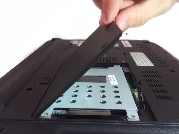

  3. Asus UL30VT-X1 Hard Drive Replacement: crwdns2935265:03crwdnd2935265:01crwdnd2935265:02crwdne2935265:0 Asus UL30VT-X1 Hard Drive Replacement: crwdns2935265:03crwdnd2935265:02crwdnd2935265:02crwdne2935265:0
    • Lift the hard drive panel up from the small cut out at the bottom with your finger to expose the hard drive.

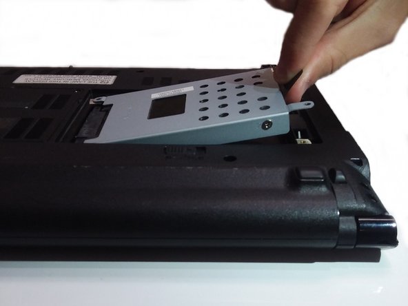

  4. Asus UL30VT-X1 Hard Drive Replacement: crwdns2935265:04crwdnd2935265:01crwdnd2935265:02crwdne2935265:0 Asus UL30VT-X1 Hard Drive Replacement: crwdns2935265:04crwdnd2935265:02crwdnd2935265:02crwdne2935265:0
    • Grab the black pull tab with your fingers. Pull upwards and then outwards to remove the hard drive.
    • It can sometimes be a little difficult to remove the hard drive.
