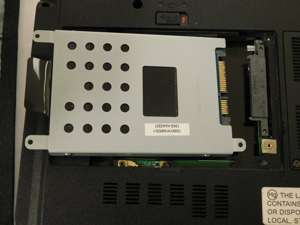

    • Flip your device so that the back of the device is facing you.
  2. Asus UL30VT-A1 Hard Drive Replacement: crwdns2935265:02crwdnd2935265:01crwdnd2935265:02crwdne2935265:0 Asus UL30VT-A1 Hard Drive Replacement: crwdns2935265:02crwdnd2935265:02crwdnd2935265:02crwdne2935265:0
    • Remove the four screws using your Phillips #0 screwdriver to attain access to your Hard Drive.
    • Remove the panel using a plastic opening tool.
  3. Asus UL30VT-A1 Hard Drive Replacement: crwdns2935265:03crwdnd2935265:01crwdnd2935265:02crwdne2935265:0 Asus UL30VT-A1 Hard Drive Replacement: crwdns2935265:03crwdnd2935265:02crwdnd2935265:02crwdne2935265:0
    • Gently pull the black strip and the Hard Drive should slide right off. Pull your hard drive to the side not up to avoid damage to the slot.
