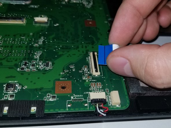

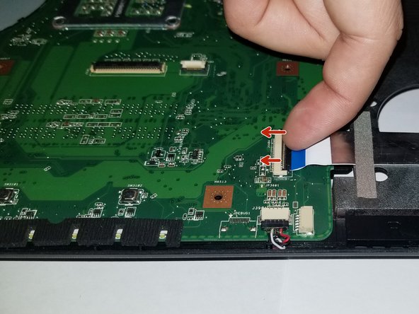

  17. Asus U56E-BBL6 Motherboard Replacement: crwdns2935265:017crwdnd2935265:01crwdnd2935265:03crwdne2935265:0 Asus U56E-BBL6 Motherboard Replacement: crwdns2935265:017crwdnd2935265:02crwdnd2935265:03crwdne2935265:0 Asus U56E-BBL6 Motherboard Replacement: crwdns2935265:017crwdnd2935265:03crwdnd2935265:03crwdne2935265:0
    • Lift up the ribbon cable connector on the bottom right corner.
    • Gently pry the cable away from the connection.

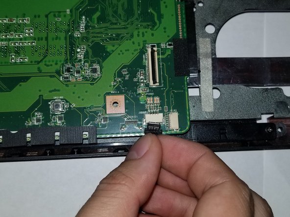

  18. Asus U56E-BBL6 Motherboard Replacement: crwdns2935265:018crwdnd2935265:01crwdnd2935265:02crwdne2935265:0 Asus U56E-BBL6 Motherboard Replacement: crwdns2935265:018crwdnd2935265:02crwdnd2935265:02crwdne2935265:0
    • Remove the 4 pronged connection on the bottom right corner of the motherboard.

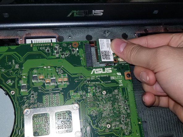

  20. Asus U56E-BBL6 Motherboard Replacement: crwdns2935265:020crwdnd2935265:01crwdnd2935265:01crwdne2935265:0
    • Repeat the previous step and remove the two wired connection next to the card.
