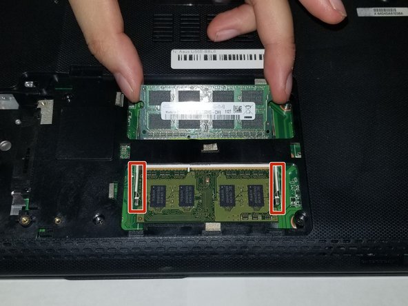

  5. Asus U56E-BBL6 Keyboard Replacement, RAM: crwdns2935265:05crwdnd2935265:01crwdnd2935265:01crwdne2935265:0
    • Once inside the panel, locate your RAM sticks.
  6. Asus U56E-BBL6 Keyboard Replacement: crwdns2935265:06crwdnd2935265:01crwdnd2935265:02crwdne2935265:0 Asus U56E-BBL6 Keyboard Replacement: crwdns2935265:06crwdnd2935265:02crwdnd2935265:02crwdne2935265:0
    • This device is embedded with two RAM sticks.
    • Push the metal brackets carefully to release and remove the RAM stick .
  7. Asus U56E-BBL6 Keyboard Replacement: crwdns2935265:07crwdnd2935265:01crwdnd2935265:02crwdne2935265:0 Asus U56E-BBL6 Keyboard Replacement: crwdns2935265:07crwdnd2935265:02crwdnd2935265:02crwdne2935265:0
    • Repeat the previous step for removing the other RAM stick.

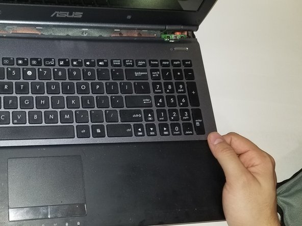

  11. Asus U56E-BBL6 Keyboard Replacement: crwdns2935265:011crwdnd2935265:01crwdnd2935265:01crwdne2935265:0
    • Ensure the laptop is face up for this step.
    • Gently lift the keyboard from the base of the laptop.
    • Be careful of the ribbon cables connecting the keyboard.
  12. Asus U56E-BBL6 Keyboard Replacement: crwdns2935265:012crwdnd2935265:01crwdnd2935265:01crwdne2935265:0
    • Gently tug the ribbon cables free from their slots.
  13. Asus U56E-BBL6 Keyboard Replacement: crwdns2935265:013crwdnd2935265:01crwdnd2935265:02crwdne2935265:0 Asus U56E-BBL6 Keyboard Replacement: crwdns2935265:013crwdnd2935265:02crwdnd2935265:02crwdne2935265:0
    • Using both hands, pull the keyboard back and out, fully separating the keyboard from the laptop.

The Keyboard still has to be removed from the Top Case! Your not done yet!
philw395 - crwdns2934203:0crwdne2934203:0
I removed the Keyboard from the Top Case and replaced the Keyboard. It wasn’t too bad with my Heat Gun and all-in-one painters tool…yes you heard right, my handy dandy painters tool that has served me well for years. Anyway, the only problem area taking the Keyboard out and snapping it back in (if you want to call it that) was by the DVD Player. Good Luck!
