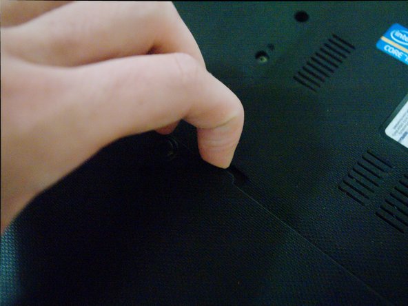

    • Make sure the laptop is unplugged before removing the battery to avoid risk of electric shock.
    • Slide the two battery lock switches toward each other.
    • Lift the battery to remove it from the laptop.

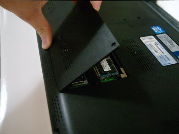

    • Remove the 3 Phillips #00 screws holding on the back cover of the laptop.
    • Lift the cover, exposing the laptop hard drive and RAM.

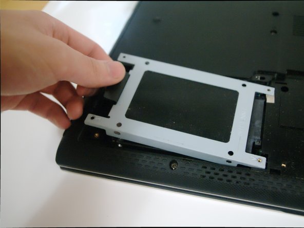

    • Remove the eight small screws holding the hard drive in.
    • The hard drive cover can now be removed by lifting the tab on the left.
  5. Asus U56E Laptop Screen Replacement: crwdns2935265:05crwdnd2935265:01crwdnd2935265:01crwdne2935265:0
    • Gently slide the hard drive left toward the edge of the laptop, then lift up to remove it.

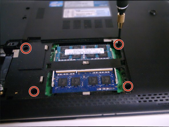

  6. Asus U56E Laptop Screen Replacement: crwdns2935265:06crwdnd2935265:01crwdnd2935265:02crwdne2935265:0 Asus U56E Laptop Screen Replacement: crwdns2935265:06crwdnd2935265:02crwdnd2935265:02crwdne2935265:0
    • Remove the 4 Phillips #00 screws around the RAM.

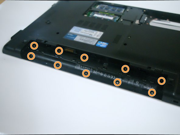

  7. Asus U56E Laptop Screen Replacement: crwdns2935265:07crwdnd2935265:01crwdnd2935265:02crwdne2935265:0 Asus U56E Laptop Screen Replacement: crwdns2935265:07crwdnd2935265:02crwdnd2935265:02crwdne2935265:0
    • Remove the 10 Phillips #00 screws from the bottom of the laptop.
    • Remove 10 Phillips #000 screws from under the battery.

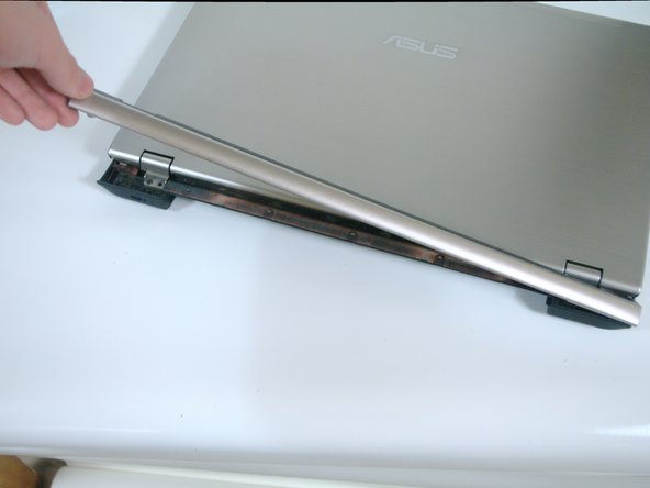

    • Slide the optical drive out of the laptop.
    • Gently lift the rear plastic hinge cover to separate it from the laptop.

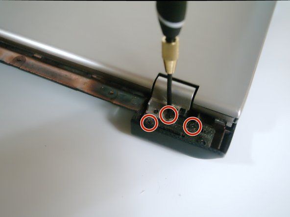

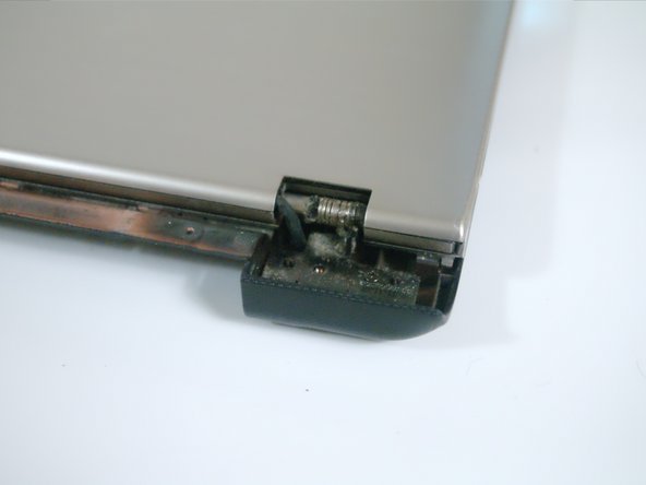

  9. Asus U56E Laptop Screen Replacement: crwdns2935265:09crwdnd2935265:01crwdnd2935265:03crwdne2935265:0 Asus U56E Laptop Screen Replacement: crwdns2935265:09crwdnd2935265:02crwdnd2935265:03crwdne2935265:0 Asus U56E Laptop Screen Replacement: crwdns2935265:09crwdnd2935265:03crwdnd2935265:03crwdne2935265:0
    • Remove the 3 Phillips #000 screws from each side of the hinge (six screws in total).
    • Gently lift the thin plastic cover from each side, exposing the laptop hinge.
    • Be aware of the thin cables still connected to the screen.

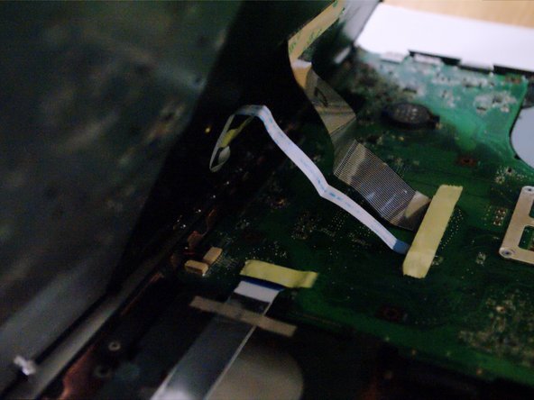

  10. Asus U56E Laptop Screen Replacement: crwdns2935265:010crwdnd2935265:01crwdnd2935265:02crwdne2935265:0 Asus U56E Laptop Screen Replacement: crwdns2935265:010crwdnd2935265:02crwdnd2935265:02crwdne2935265:0
    • Gently lift around the perimeter of keyboard to separate it from the laptop body.
    • It may help to use a Plastic Opening Tool.
    • Be careful not to pull too hard on the keyboard - It's connected to the motherboard with a thin ribbon cable!

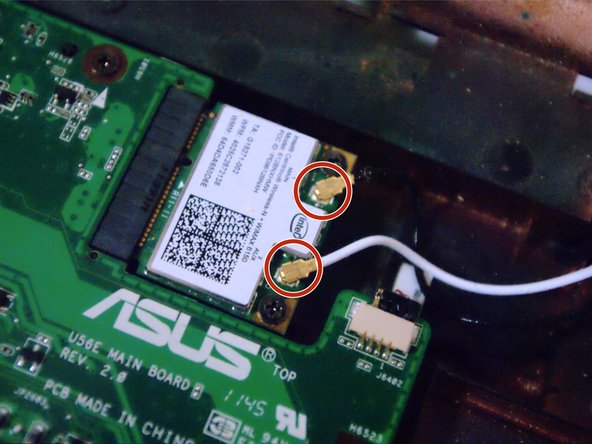

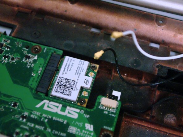

  11. Asus U56E Laptop Screen Replacement: crwdns2935265:011crwdnd2935265:01crwdnd2935265:03crwdne2935265:0 Asus U56E Laptop Screen Replacement: crwdns2935265:011crwdnd2935265:02crwdnd2935265:03crwdne2935265:0 Asus U56E Laptop Screen Replacement: crwdns2935265:011crwdnd2935265:03crwdnd2935265:03crwdne2935265:0
    • Pull the display connector straight up to remove it from the motherboard.
    • Carefully detach the white and black WiFi antennas from the wireless adapter.
  12. Asus U56E Laptop Screen Replacement: crwdns2935265:012crwdnd2935265:01crwdnd2935265:01crwdne2935265:0
    • The screen can now be safely removed from the laptop.
